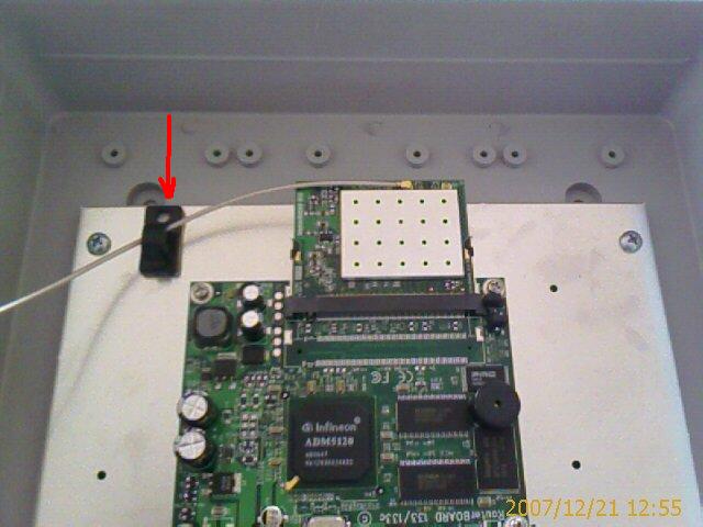

We have developed our own CPE’s we sercure the pigtails by using small plastic clips with adhesive back, this holds the cable to the backing plate, we have made hundreds of these and never had an issue.
