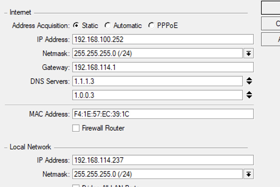

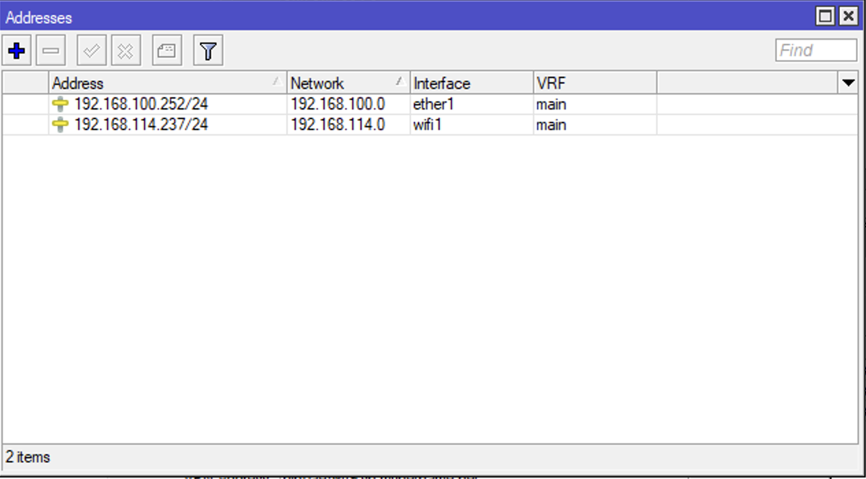

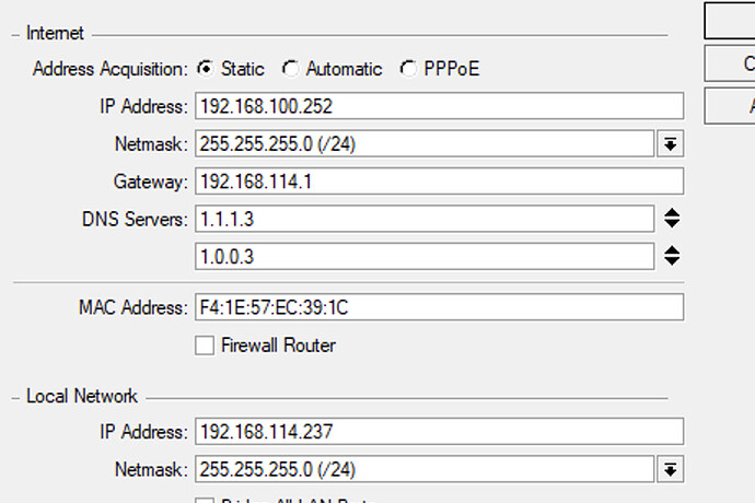

Is it bad in quick set?
The local IP should be 192.168.100.252 and on the WAN side 192.168.114.237
