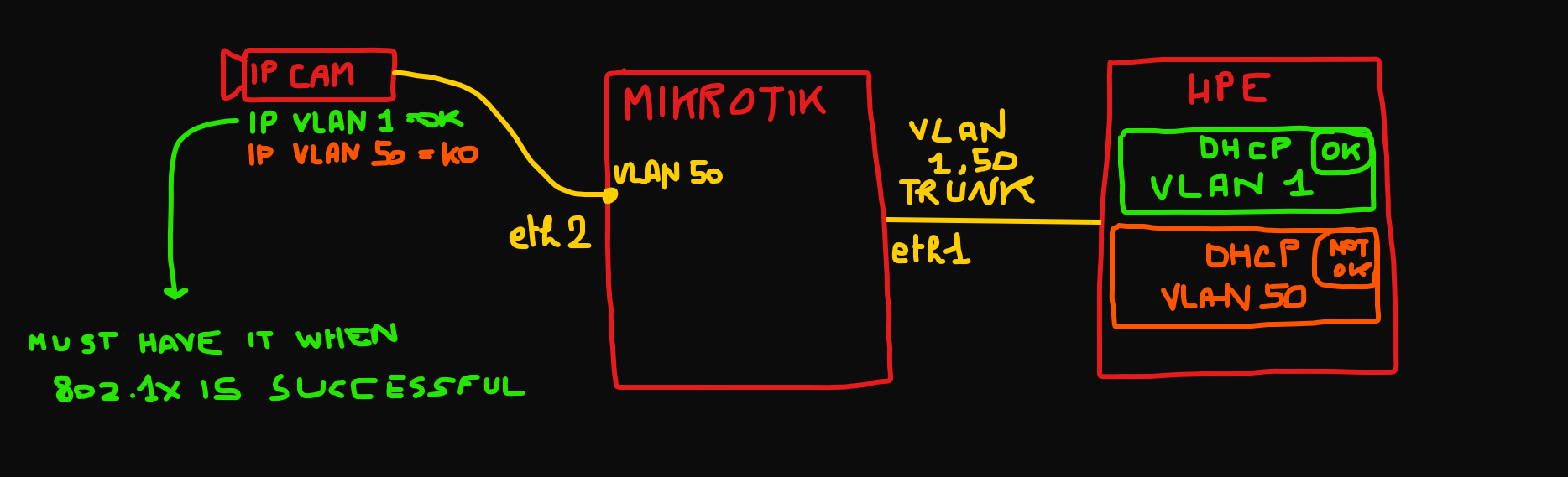

Hello!
I changed the topology: the eth1 is the port of the trunk, eth2 is the port of the IP camera. The DHCP for VLAN1 is working, also I noticed that even if I put the IP camera in vlan 50, the ip address gained in vlan 1 still works and is reachable. Now the 802.1x on the eth2 is disabled, so the device must use the VLAN 50

Hello!
Below the diagram and the configuration. I changed the topology: the eth1 is the port of the trunk, eth2 is the port of the IP camera. The DHCP for VLAN1 is working, also I noticed that even if I put the IP vcamera in vlan 50, the ip address gained in vlan 1 still works and is reachable. Now the 802.1x on the eth2 is disabled, so the device must use the VLAN 50

As situation isn’t clear, use Torch or sniffer to see which traffic goes to which interface
I disabled it via winbox, using “disable” for 802.1x on the single port, the 802.1x is strictly needed but for now I’m happy if we put the camera in the conditions to have an IP in vlan 50, I don’t use IVL
Since I can reach the camera on a VLAN 1 IP address assigned by DHCP, even if the port is in VLAN 50, it seems that the switch is ignoring the vlan 50 or putting all the incoming/outgoing traffic in VLAN 1, do You know what might cause this behaviour?
Thank You
IlKa
December 16, 2025, 5:11pm
9
please, show your config
This is why I suggested to use Torch or Sniffer (both available in Winbox) to see which traffic goes where.
