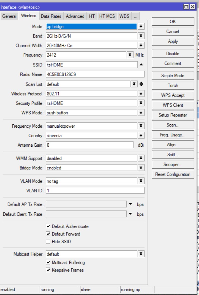

This is my wifi settings
Quick suggestions:
Band: Use only 11n unless you have old clients to support.
Channel width: Use only 20MHz. Period! 40MHz in 2,4GHz is very bad practice!!! Will cause interference.
Frequency: Make sure that 2412 is free (or not too busy)… Always stay with 1,6,11 for channels (non overlaping).
WPS Mode: Disable it. Evil!!! Potential security issues.
Frequency mode: Use “Regulatory”. Respect your country’s regulations.
And in the other tabs, make sure you use default parameters for power output. It’s easier to play with “Antenna gain” to fool the radio into lowering TX power than to play with the other parameters.
And as always, and mentionned in other replies, it’s better to reduce power output and add a router than it is to blast it. Imagine you sitting next to a 15" speaker blasting heavy metal music real loud!!! That’s how some devices might regard your AP like. :wink:
Regards,
