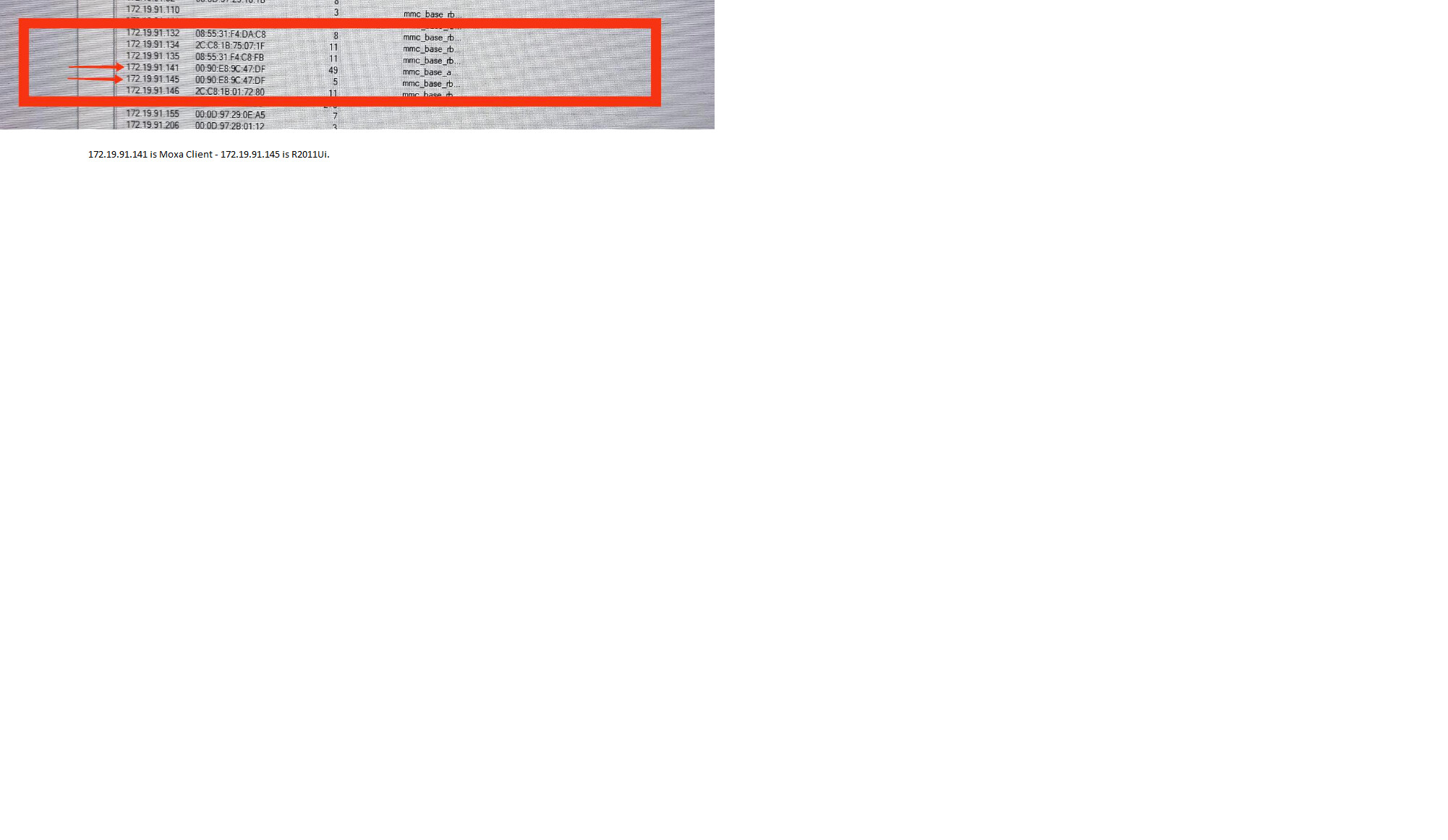

I have a network that the basic layout is:
I have an Rb2011 router installed on a machine and to connect to the wifi network I am using a moxa radio awk-4131 as a client. Then he connects to the network with the Ap mikrotik in Layer 2 until he reaches another Rb2011 to follow within the main network.
The information traffic is working normally, the problem is that the Router Rb2011 installed on the machine when it goes up in the network it has the same MAC of the Moxa radio that is the client.
Does anyone know what I have to do, for the Router on the machine to go up on the network and remain with the same MAC?

  • Yes, You have one R2011Ui.
Do you think there is some configuration on the router behind the wirelles bridge, which can generate transparency and prevent the rest of the network from seeing this MAC duplicity?
If you read the article I linked you’d find out that it’s not possible when using wireless equipment mix by different vendors.
