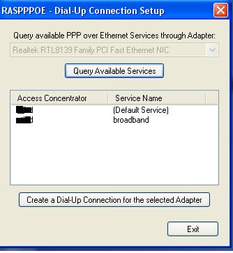

By using “Raspppoe” at client’s end, problem can be solved. if u press query, then it will shows the all services in this lan, then u have to select the service name (pppoe server name) and create a dial up.
If u want u can catch that client’s who made another ppppoe server or other server on this same lan. For that u have to remove one by one cable from your lan switch and press query available.

u have to connect your pc to your lan switch (client’s switch). Now check query , if unwanted service is available,then disconnect the one cable and check query,again disconnect other cable and check query.
Now u can find out which cable is responsible for unwanted service. and this way u can get the client’s.

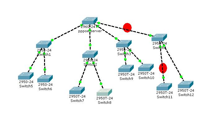

if we have a lot of users for example 5000 users ?
does n’t matter 200 clients or 5000 clients, If u have more clients then u should have more switches. First u have to start from Core switches then others.
