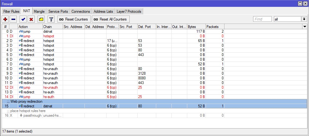

Can you post the info from “/ip firewall nat”?

That solution would indicate your masquerade or srcnat is incorrect.
You probably have this
chain=srcnat action=masquerade src-address=192.168.100.0/24
That is the nat rule added by the hotspot.
You need something like this:
add chain=srcnat action=masquerade out-interface=ether1
I don’t use masquerade.
I want to export my firewall nat rules , but its return only 2 of 9 rules.
Then I presume you have the 192.168.100.0/23 net routed back to the router from the proxy server. That would make sense.
:slight_smile: Once again Thank You a lot :slight_smile:
Yeah, and that the router with proxy server (172.16.1.1) does also masquerading for 192.168.. addresses only :slight_smile: - that was probably the problem, why the RB couldn’t connect, as it was not NATted outside.
