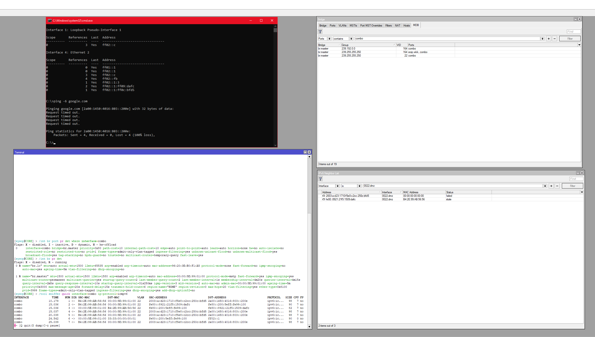

I have a few clients in a dmz (vlan 22) that use IPv6 for internet connectivity. After a machine boots, it gets the prefix and gateway via SLAAC, connectivity works without issues.
Once the Neighbor entry for this client times out, and the client tries to establish a connection using IPv6, it fails.
In the screenshot you can see the configuration of the bridge and the port the client is connected to (via another smart switch).
The traffic capture shows the traffic when the client tries to ping google.com.

When ROS tries find out the mac-address of the client by sending a Neighbor Solicitation Message, from the router’s perspective no client (bridge port) has joined that specific multicast group, and since igmp snooping is enabled on the bridge, the NS won’t leave the bridge.
As a result the router won’t get a Neighbor Advertisement back, the client’s mac address is shown as 00-00-00-00-00-00 in the neighbor list and communication fails.
To me the problem seems to be that the bridge at some point removes the multicast group of the client from the mdb table, while Windows has still joined that group.
GROUP                                                                                VID PORTS                                    BRIDGE
ff02::1:ff0c:bfd5                                                                     22 combo                                       br.master
