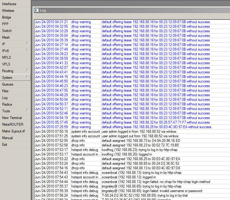

Everynow and then My Hotspot AP will seem to stop giving out leases, seemingly because of an
accumulation of 1 or 2 clients being offered leases and not getting one. The AP keeps trying to hand out leases to the one or
two clients. The other clients seem to have IP’s but the CCQ is non existent on any client.
After a point it seems to keep the other 4 or 5 clients from getting IP’s at all.
If I reboot the AP, all is well.
Any ideas?
the Picture shows the problems in blue, then after rebooting AP the rest seem to be fine.
Hi oceanwifi! Is it always the same mac address?
Looks like 00:23:12:09:67:0B
If the pattern continues with that mac address, you might consider blocking a connection
/int wireless access-list
add mac-address=00:23:12:09:67:0B authentication=no
Hey SurferTim,
I have started doing mac filtering on the AP. And yes, I think you’ve got the right approach. But nope, it’s not always the same mac.
And, if you notice the last 2 macs are taken out. They are very close and are generally good. So, I don’t know if the previous device with the many failed lease offerings, took them out. I don’t know why it (AP) can’t adjust and settle back in, I believe that’s a function of auto-ack? , that’s just not working.
I get a lot of distant clients, that might be passing through. Sometimes they stay in the area just out of their range, but within range of
My AP, meaning My AP can see/hear them but they can’t hear my AP, sorta.
So, I started filtering those types of clients, and seems to help with CCQ and ack seems to become stable.
Ofcourse, I can’t do that on a 24 hr. basis, If that is actually what’s causing the problem.
I mentioned previously, I had a client come in with an amplified (1amp) 9dbi omni, (5-milewifi) :open_mouth: . He, was @ 100 yrds, away, but the auto ack on my ap wanted to go 27 kms. Completely screwed everything up. Gave him an alpha/gsky usb external , everthing was fine.
I may not have mentioned, I’m running a hotspot in a marina.
So, I get a lot of different clients :confused:
Anyway, back to the boards, thanks for the input.
I had a challenge like this a couple years ago. I had my radios (R52H) set for max power. The problem was they could hear my transmitter, but I couldn’t hear theirs. I now set my transmitters to 22db and use antennas to increase the gain to max allowed by the FCC.
Thanks again,
I’ll turn my ap down a couple db, was at 28.
