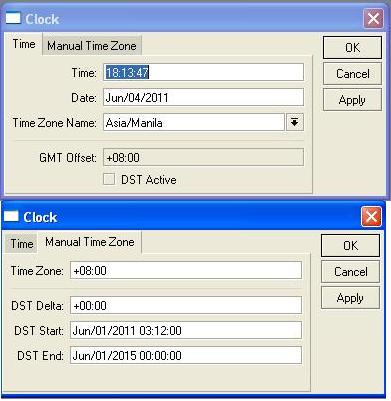

Guys,
If i reboot my RB493AH the system clock reset back to 1917, (something like that) this happen everytime i reboot my router.
Guys,
The RB units have no battery backed system clock. You must set NTP to reset the correct time after a reboot.
/system ntp client
hello surfertim, what is the command to enable NTP to reset the correct time after a reboot.
thanks
