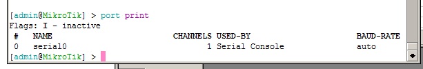

I have purchased cloud router switch crs125-24g-1s-2hnd several weeks ago.
As it comes with usb cable, so i wish this router can connect with usb modem.
I have try to follow instruction from http://wiki.mikrotik.com/wiki/Option_Globetrotter_HSDPA_USB_Modem ,
but when i try to check usb port using command : port print
i can not found any usb port in the list.
Is there any options to enable usb port or add usb port in the list?
Thank you so much

hi,
I'm having the same issue, i've plugged in a USB LTE modem and system shows USB;
/system resource usb> print
DEVICE VENDOR NAME SPEED
0 1:1 Linux 3.3.5 ehci_hcd RB400 EHCI 480 Mbps
port print shows only serial;
port print
Flags: I - inactive
NAME CHANNELS USED-BY BAUD-RATE
0 serial0 1 Serial Console auto
OS is 6.7
any ideas for a fix welcomed

ya tried that, also tried alternate usb cable
It’s as if the port is dead
