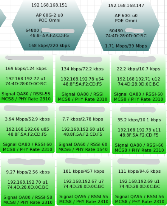

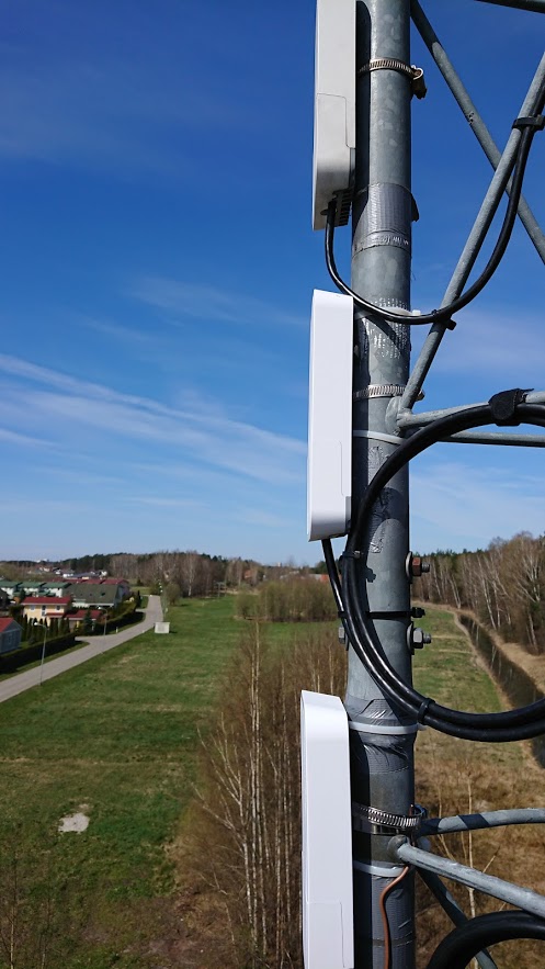

My experimental co-locate.
Each wAP 60Gx3 AP works on its own frequency with auto beamfroming.
Clients are connected to the first and third, according to compatibility (regardless of the distance, others prefer 64800, others 60480).
All links work perfectly.
For the average wAP60Gx3, no one is connected, but tends to disconnect by itself (warranty option possible).
Maybe someone has their own co-locate experience?

So you have 3 WAP APs, what about the Clients ? Models ?
Electricity is supplied but the ping does not go.
There were reports from the customer of a complains, I turned off the electricity (probably the wireless worked, at least the power consumption was the same).
I replaced the cable and PSE (power sourcing equipment), it also doesn’t work all day and shuts down.
I am currently testing without wlan60-1 turned on.
Cube Lite60, Cube 60G ac, Wireless Wire nRAY.
