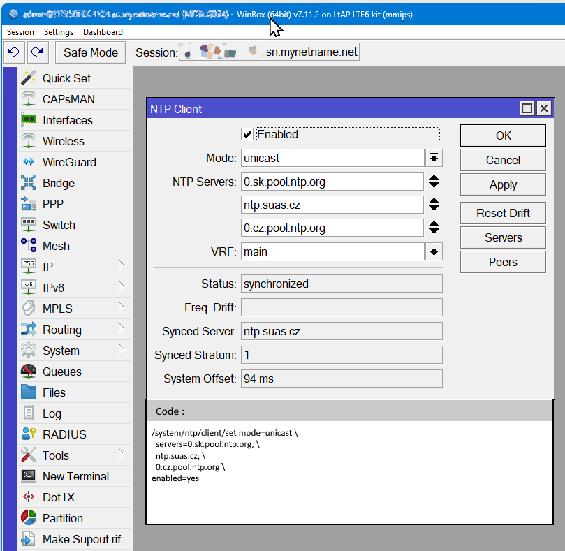

Code example
Is it possible to add to WinBox a preview of the code that is generated by the set configuration?
For example:
