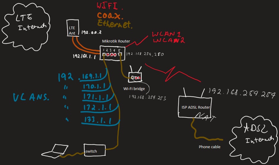

Here is a diagram of my setup.

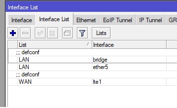

add comment=defconf interface=lte1 list=WAN
add interface=ether5 list=LAN

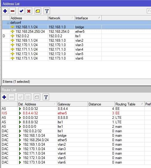

add disabled=no distance=2 dst-address=0.0.0.0/32 gateway=8.8.8.8 pref-src=0.0.0.0 routing-table=LTE scope=30 suppress-hw-offload=no \
    target-scope=32
add disabled=no distance=1 dst-address=8.8.8.8/32 gateway=lte1 pref-src=0.0.0.0 routing-table=LTE scope=30 suppress-hw-offload=no \
    target-scope=31
add check-gateway=ping disabled=no distance=4 dst-address=0.0.0.0/32 gateway=8.8.4.4 pref-src=0.0.0.0 routing-table=EE scope=30 \
    suppress-hw-offload=no target-scope=38
add disabled=no distance=2 dst-address=0.0.0.0/0 gateway=lte1 pref-src=0.0.0.0 routing-table=main scope=30 suppress-hw-offload=no \
    target-scope=10
add check-gateway=ping disabled=no distance=3 dst-address=8.8.4.4/32 gateway=ether5 pref-src=0.0.0.0 routing-table=EE scope=30 \
    suppress-hw-offload=no target-scope=37

What testing have I completed to look at the problem:
  1. No LAN client is able to ping the “copper” WAN side 192.168.254.253 and 192.168.254.254 both fail but 192.168.254.250 (ether5 on the router) works ok.
  2. From a terminal session on Mikrotik ping 192.168.254.250, 192.168.254.253 and192.168.254.254 all working, but beyond that fails. ISP DNS, 8.8.8.8, 8.8.4.4 all fail [with LTE disabled leaving only copper up to transmit from].
  3. When I check “log” on the four default drop rules, no log is generated – so no packets are being dropped – I suspect this is because I am generating ICMP traffic for which there is a rule to accept.
  4. When connected to the ADSL router either with ethernet or via its WIFI all expected WAN connections are working.
What do I need help with ?
I can’t use the new copper internet via PCC as I would like, this is the main issue I want to fix.
If I disable the LTE1 interface the WAN goes offline and does not fail over.
As far as I can tell, the problem is that packets from the LAN do not get routed to ether5 default gateway. As far as I can tell this is not because they are being dropped by the firewall. I am wondering what other information I could provide to shed further light on the problem and whether the problem lies in the way I have set up the addresses and or routes or is in fact a problem I am as of yet unaware of?
Finally I am attaching a couple of screen shots from the Winbox as sometimes this is quicker than reading a lot of text.
Thanks for all previous replies and any pointers or tips offered on this problem.

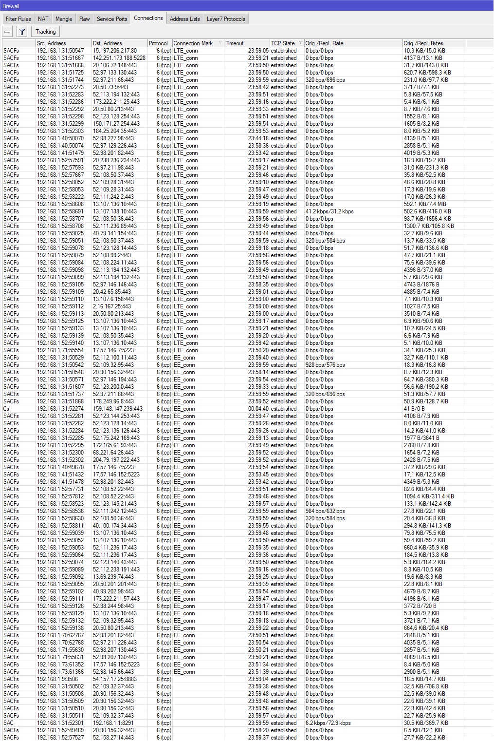

This shows the rules are working, but what’s happening is that while the connections are being marked, they are all failing back to the LTE side since the “EE” side is down - I can see that in the Mangle statistics.
What I particularly notice is that the packet count is broadly equal but the byte count is nothing for the EE side and all on the LTE side [highlighted line].
Your ether5 is not defined as WAN ?
Why not ?
And why not use default srcnat rule for interface-list WAN ?
The reason for ether5 not being in WAN and the modification of the default srcnat rule is to avoid packets destined for transmission over the Copper WAN from being Nat’d as they leave the Mikrotik “WAN” [for which there is a mangle NAT rule] and then being Nat’s a second time as they are transmitted outward from the copper ADSL modem.
I could since I have now modified the Nat Mangle rule, but Ether5 back into “WAN”. But if I do that I am sure whether I would then need to remove it from “LAN”. If I remove it from LAN the rule which drops all input not coming from LAN would then be true and drop those input frames.
Therefore, until I get more vision on the matter, these are my deductions.
Many thanks again
That drop rule will only be effective for connections coming straight in.
If they first go out, they are established, return packages are therefor not new and will be accepted.
IMHO ether5 should be considered WAN, not LAN.
Thank you accepted and understood.
I have removed ether5 from LAN and added it to WAN.
Still no ping from an ethernet connected client out on the copper side - but still pinging fine from the Terminal screen

Scratching head on already raw spot.
Quite a bit of progress:
Thing 1:
By defining routes of 1 ip address I have determined that the ADSL side IS working.
ip/route/add dst-address=92.123.241.137/32 gateway=192.168.254.254
ping 92.123.241.137
SEQ HOST SIZE TTL TIME STATUS
0 92.123.241.137 56 55 7ms450us
1 92.123.241.137 56 55 7ms348us
Thing 2:
I have also determined that if I set the lte1 interface to Check Gateway = “ping” it will always determine incorrectly that the gateway is US after 10 seconds. I realise its one OS that Mikrotik supply for all devices so . . . ping may be inappropriate for the destination I am specifying (I need to read up on a better dead gateway detection method for lte). This has a knock on effect on the routing table selected which confuses matters.
Thing 3:
The big one:
Hands “up” I had not completed the PCC video [which armed with better comprehension, I watched again to be sure that I had not made a cock up]; I had. For some reason I had completely missed the fourth set of rules “mark packets from lan in prerouting for routing tables LAN and EE” so that they can at least be processed by the relevant routing table.
Finally then I see traffic on both the ether5 and LTE interfaces in the interface list.
But, it does not work…
What does not work ?
  1. New problem, I am unable to ping anything external from my PC connected to ether1 - but I can ping anything external from terminal and also shape the WAN connection used for tests with static routes. This all works perfectly and as expected.
  2. Existing problem, if I disable the LTE interface we loose the internet completely. This has always been the case.
  3. Since the mangle rules are all now working, I actually do fail to reach sites down the ether5 side when the route for the EE routing table is enabled. So for now this is disabled (even though its enabled in the attached output).
It just still seems that packets from “LAN” which includes “bridge” which includes all the VLAN’s ether1 and the two wifi interfaces, do not make it to ether5. Statistically they do in terms of the mangle rule counters and in terms of the traffic TX / RX counters in the interface list, but as I experience it on my PC, it does not work. So something I do not understand is still broken.

Specifically what fixed it was FW → NAT → rule 0 - which I had changed.
What had I changed ?
I had changed the “OUT. Interface List” = NULL and replaced that with the “Out. Interface” = lte1.
Why?
Because at the moment I am doing double NAT out of the Mikrotik and the ADSL router. It works but I think double NAT is a problem which I will hit down the line.
The problem surrounds the meaning in ROS of the interface WAN. My understanding is that wan is a logical group into which to place interfaces which are going to be remote to the local location. Therefore, it should be possible to specify those interfaces individually as opposed to by logical group. This is what I did by subsuming (“OUT. Interface List” = NULL and replaced that with the “Out. Interface” = lte1.) But 100% this breaks it and also prevents routing over ether5 for sure.
So something more is going on with this WAN meaning than just a logical interface group.
