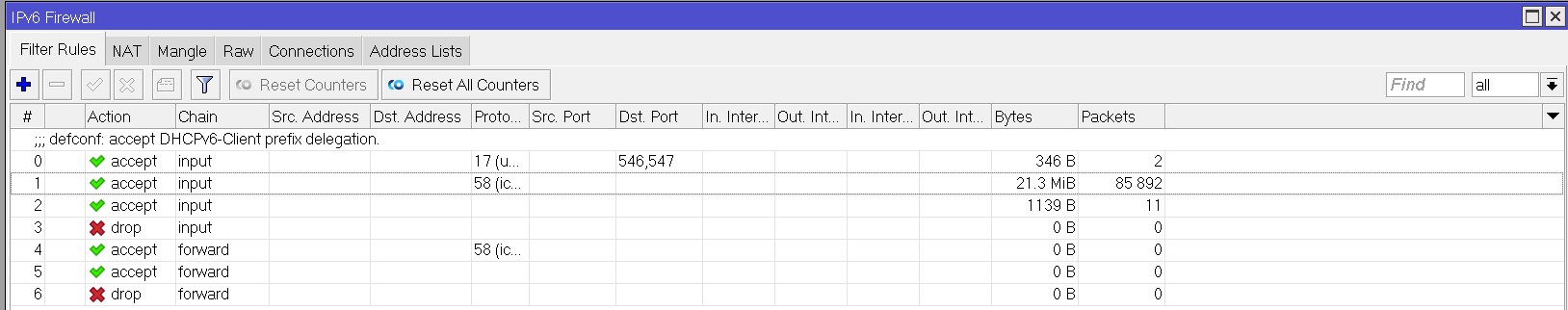

hello, i was wondering if i could get some help with setting up ipv6 on comcast.
it all used to work before they changed my node out for an rphy node about a year ago, that day it stopped working and i cant figure it out ever since.

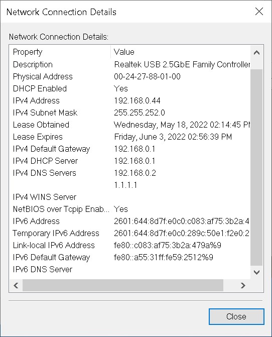

with my current settings i can from my router ping the internet and lan, and with my computer i can ping the router, both the wan side and lan side
and from the internet i can ping the router, both the wan and lan side, the /64 it gives the lan interface
but i cannot figure out how to get my computer to ping the internet, or get the internet to see my computers, and ive read the limited amount of posts on here about it, changed a few things, and im stuck.

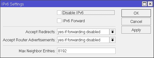

posted my current config in attachments, maybe im doing something wrong.
firewall im assuming needs a lot of work, was just hoping by disabling everything it would let all traffic pass, maybe it doesnt work like that
thanks in advance
Screenshots rarely provide all the information, posting the configuration (from running /export in a terminal window) after redacting any public IP addresses, serial number, etc. provides the exact setup, in this case /ipv6 export is probably sufficient.

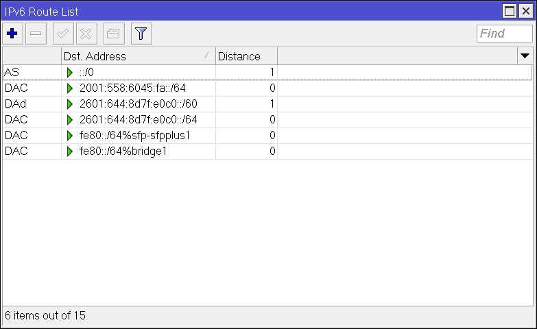

You appear to have disabled IPv6 forwarding so there will be no routing between LAN and WAN. Re-enable that and set Accept Router Advertisments to yes. The static default route is likely wrong.
thank you so much, changing to enable ipv6 forwarding made it work instantly!
i just remember one time having it enabled and absolutely nothing would work with it at one point, couldnt even grab anything with the ipv6 client, and disabling it made things work
well, it works as of now, i guess its time for me to start messing with the firewall settings.
