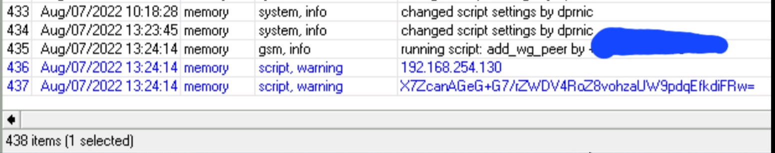

/system/ssh address=192.168.240.9 user=dprnic command="/interface/wireguard/peers/add interface=wireguard_users public-key=\"$publickey\" allowed-address=$ip;";
The result is ok.

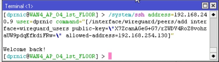

First in cli

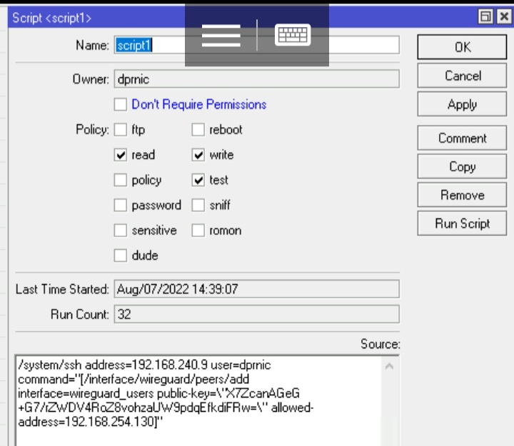

Then in script

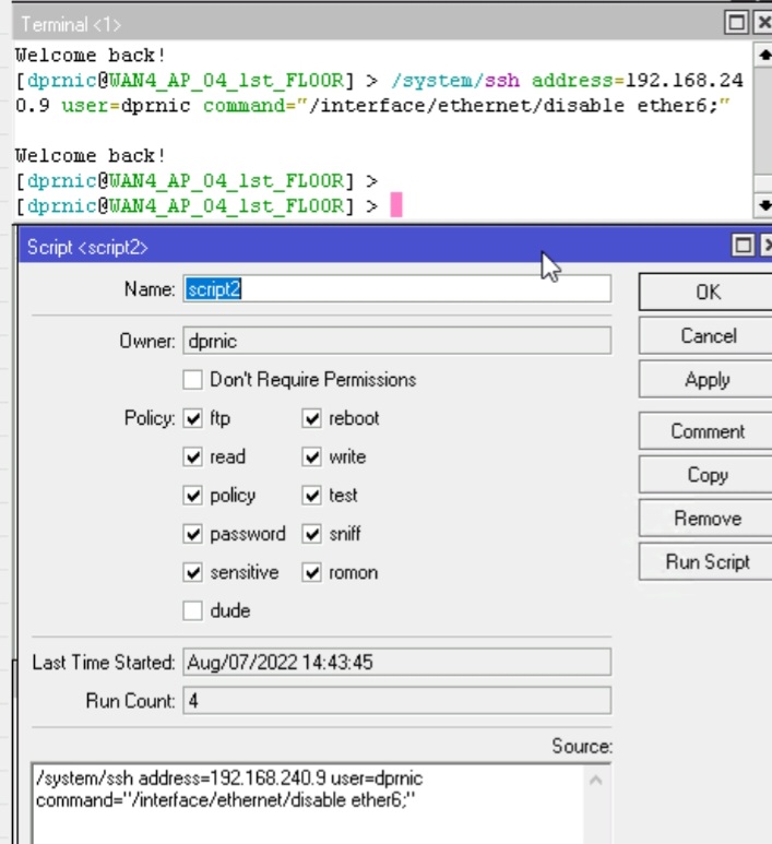

I tried something more simple also from cli and from script, but it also does not work from script and works from cli.

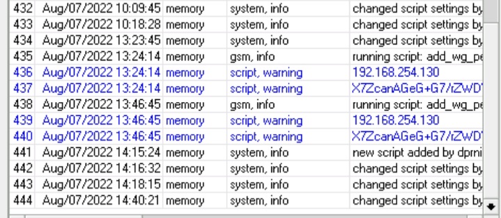

No extra log on local router

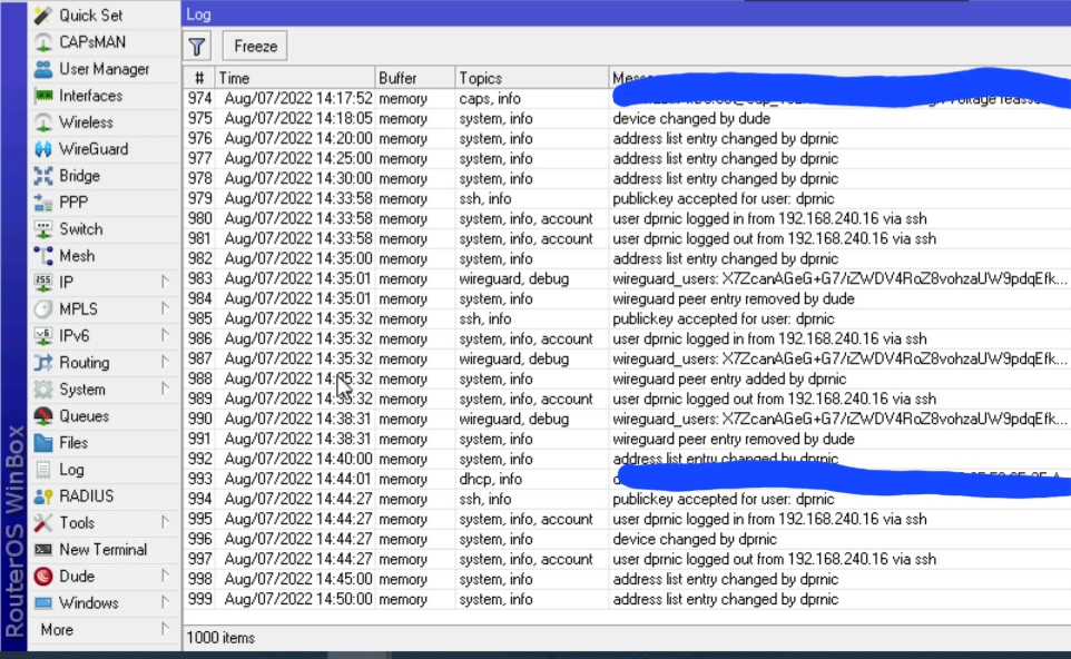

Remote router log only when i succesed with cli
