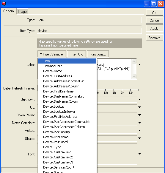

I all,
I don’t know if is useful but i found that.
There show us only the time and not the date.
Can we Find the code of this variable? If we can it will probably be more easy to compare with my time server device.
Regards
