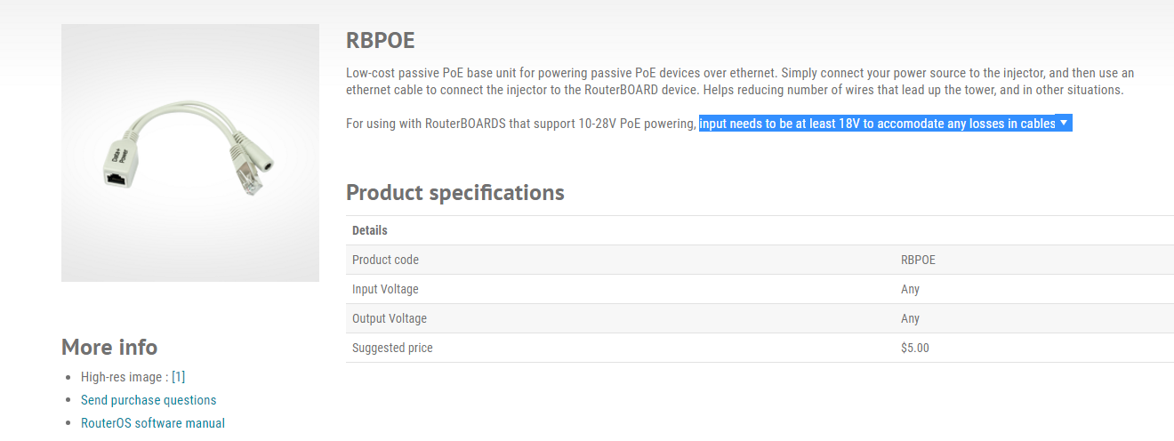

but it official from Mikrotik store

use voltage around 20-30V.
I think amps is more important, I have 12V 3A power adaptor, but ok

Measured the speed again, about 10MB, when main router have all 100MB/sec, so I dropped 220V line to my attic, powered the router directly and now all works just fine :slight_smile:
now I wondering, why is that !? power adapter have 12VA, router needs only 8, I am disappointed in POE technology

No need to be disappointed. You need to understand the physical principles. Just remember to use higher voltage when thin long wires are in use. Nothing strange.
