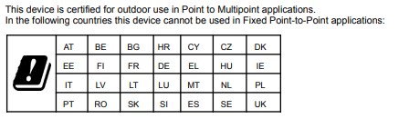

60GHz has a much smaller Fresnel zone (and Fresnel must be clear for 40%). No experience with 60GHz but it will not penetrate any obstruction. (Even rain could be some obstruction)
I’m not sure if it is allowed in my country. Distributors claim it is. But in the Quick Guide I read:
