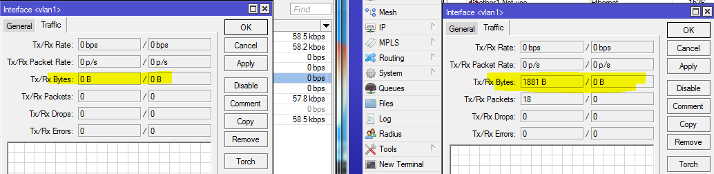

O.K.
Now I can see that I get ping from 1 computer to another.(all good )
but I don’t see the data “moving” in the VLAN (I did ping from both computers and this is the result)
let say that this is O.K. , and this how it’s working
