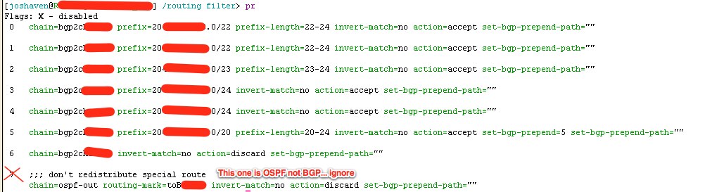

You can creat a route filter to drop all announcements except for your IP’s and use the filter on your bgp interfaces to ensure you only announce your ip space.
Do you have a sample config on how to setup this filter?
See attached route filters
chain=bgpfilter-21 prefix=1XX.XXX.XXX.0/21 prefix-length=21-24 invert-match=no action=accept set-bgp-prepend-path=“”
chain=bgpfilter-21 invert-match=no action=discard set-bgp-prepend-path=“”

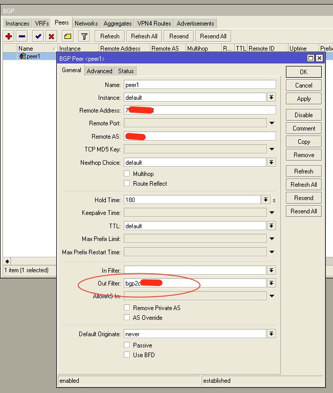

I have both my ISP’s set to Out Filter=bgpfilter-21.
Where do I need to use the in Filter, or just the out?
It sounds like you got it. You could call your upline and have them watch your routes and then ensure that you are not attempting to advertise something you shouldn’t then try to advertise a private or something to ensure your filter is right.
Or if you have a couple of routers you can build your own test then watch the routes and route filter effects to gain comfort with them.
