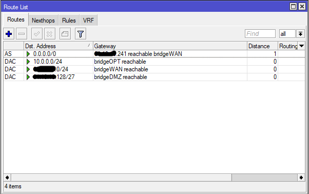

On the area router .128 I have route config like on picture. Only one static is to the GW of my ISP.
I was asking about addresses.
The addresses are same for example scope is 80.50.10.128 - 80.50.10.152 with /24 mask from ISP.
So you have overlapping subnets on LAN and WAN? That would explain why it doesn’t work. If that’s the case, then possible solutions are:
a) Ask ISP to route a different /27 to you.
b) Connect clients with public addresses directly to ISP (add their port to bridgeWAN, give them /24 mask and same .241 gateway as used by router).
c) Keep everything as is, but enable proxy ARP on bridgeWAN interface.
