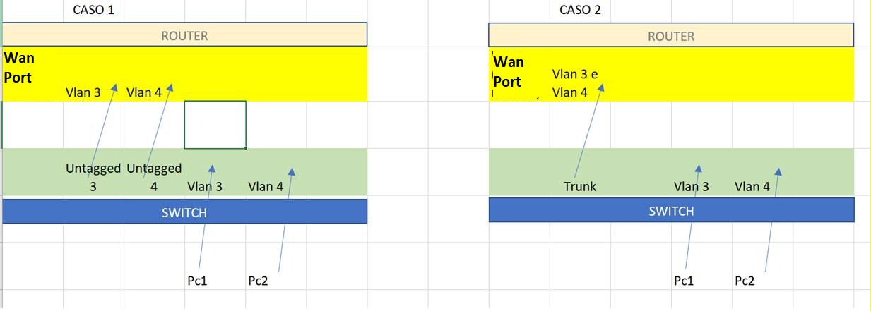

In first case I connect a cable for each VLAN to the different ports on MicrotikRouterBoard arriving from the corresponding ports (of same VLANs) of the star-point switch .
In second case I connect the cable on the port of Microtik router that accepts differents VLANs from the trunk port of star-point switch.

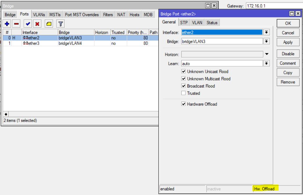

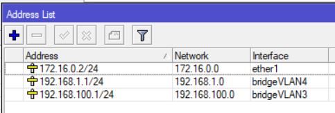

The first solution is to create a bridge one for each vlan and then assign different IPs of different VLANs to each bridge in IP address configuration,
I think that this solution is an hardware solution because I see “HW offload” in bridgeport configuration. Is correct?

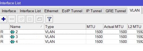

The second solution is a software solution in interface configuration:

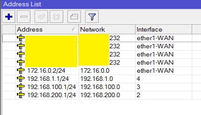

and then I assigned the addresses to each
