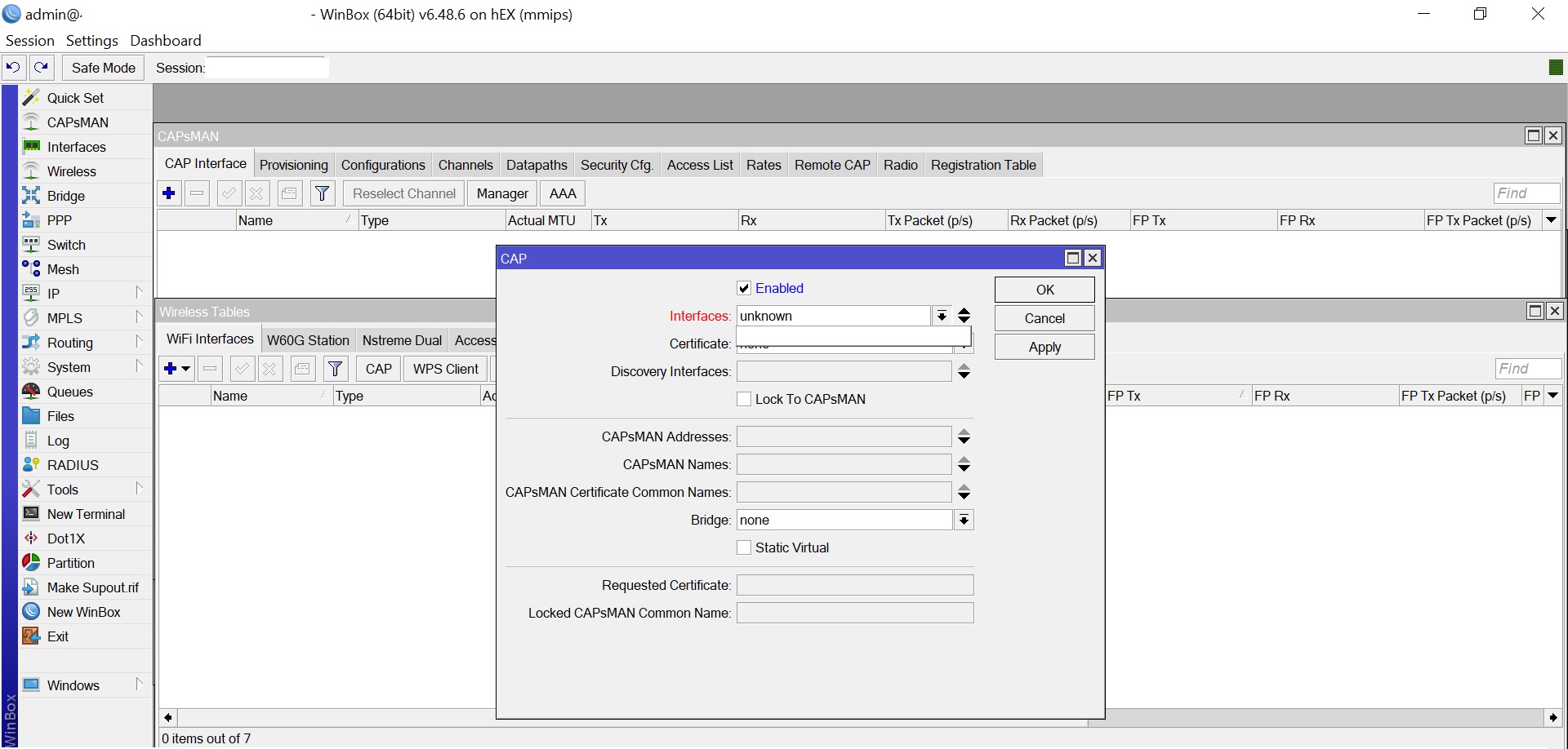

I Bought hex RB750GR3 + 2x cap ac RBcAPI-5acD2nD. I’m trying to run a capsman on this RB750GR3.
I saw few tutorials and configured according to them. At a certain step(Wireless tables–>CAP), however, I have a problem - the inability to select the interface. Description in the attachments. Probably I need to create an interface. The question to you is where and exactly what interface to create. Many thanks in advance for help :slight_smile:

Update: CAP interfaces are added dynamically, when the CAP registers to the CAPsMAN. Just follow the wiki.
