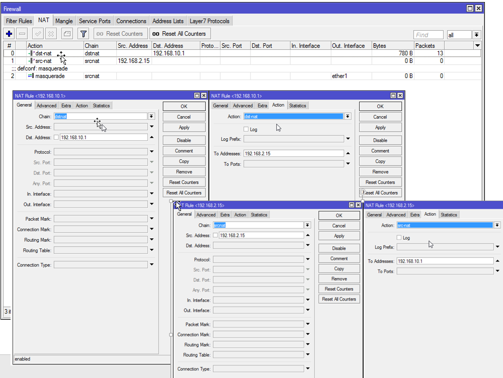

I want to configure a mikrotik hAP Lite to do 1:1 NAT but having some problems with that.
I want to achieve, that all data coming to eth1 (assigned in routerOS to 192.168.10.1) were directed to a client device on eth4 (static ip=192.168.2.15).
So I think 1:1 NAT is the right thing for that job.. is that right?? :question:
The last two days I’ve tried several different configs from web, but always without success..
my current config is showed below. Can anybody please help to find my mistake?
For testing, I tried to ping 192.168.10.1 from my computer (192.168.10.5) but didn’t get any response!
Thanks and regards!

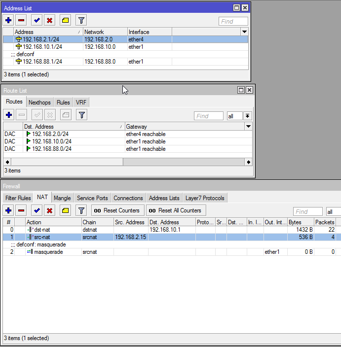

Router doesn’t know about 192.168.2.15 plugged in ether4. You need to have a route for it. Easiest way is to add address 192.168.2.x/24 on ether4 (/24 is most likely netmask). Also the device must be able to talk back to router, so that “x” in the address must be what device has set as default gateway.
Sob, thank you for your answer! :slight_smile:
The device has following settings: IP: 192.168.2.15, Subnet 255.255.255.0 and Gateway 192.168.2.1
So I added 192.168.2.1/24 to the address-list of MikroTik. The route was generated automatically.
But ping is still not working.. Are there any further settings necessary?

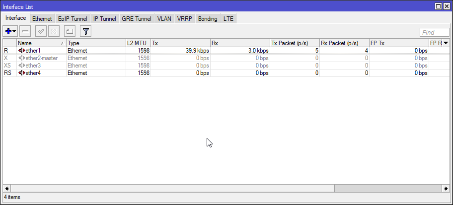

It looks like ether4 is set as a slave to ether2?
Look in the interfaces → ethernet configurations on ether4.
Does it say master port = ether2?
Then move the IP address 192.168.2.1/24 onto ether2
That was the trick!! :slight_smile:

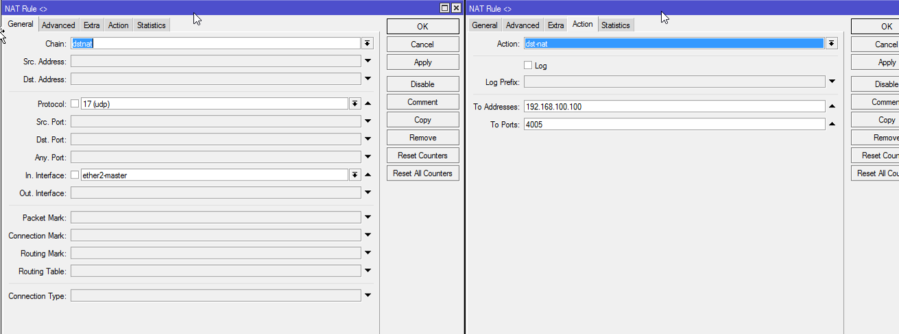

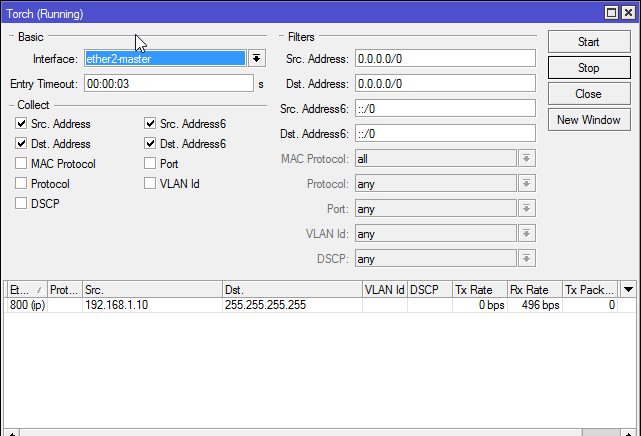

I have a new problem.
A device (IP: 192.168.1.10) on port 4 of my mikrotik haP Lite is sending UDP broadcast messages. (to 255.255.255.255)
Mikrotik should redirect all UDP/broadcast messages from port 4 to a device on port 1. (IP: 192.168.100.100)
Torch in Mikrotik is showing the broadcast message but it seems, that my NAT rule doesn’t work.. It doesn’t arrive any message at my computer (tested with wireshark)
For testing I’ve send the UDP-Message to 192.168.1.254 instead 255.255.255.255 and then the UDP-messages arrives on pc. (wireshark)
What is going wrong? How can I fix it?
You could try specifying dst-address=192.168.1.255 in the nat rule, but in general, UDP broadcast redirection is not a feature available in Mikrotik.
The only thing that ROS has the feature to do this with is DHCP relay.
