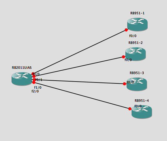

I am trying to mount a hotspot . I already set up a working hotspot with userman on a single RB951. Now I am trying to setup a hotspot on a Rb2011UiAS as the controller and a few Rb951s as the access points.
I am attaching the image of the configuration. I´m having trouble while configuring the hotspot on the RB2011 because it doesn’t have a wireless interface.
The hotspot feature is independent of whether the unit has a wireless interface or not. You can set up the hotspot on any interface.
