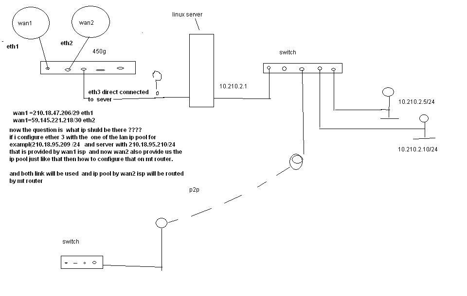

my question is i am configuring two wan link on mikrotik 450g router.both isp provided me public ip and lan pool. for example wan1 10.0.0.10/30 and with lan pool 10.0.10.90 to 100/24. And 2nd isp gave me the wan ip 172.16.0.10/30 with lan pool 172.16.0.70 to 84/24.after creating interfaces for wan link (wan1 and wan2).
Now one port of mikrotik 450 goes to my linux server that hold my user database. ( i submitted the image of my network diagram ).
at first i configure the mikrotik router with two wan ip and now one link goes to the server.
what ip will i assign on that port, that goes to the server.
what ip address i will i use on ether3(mt 450) besause both link will be used. wan1 for corporate and wan2 for home client. so what should i do for that (there is no need for natting on mt router because after server (where my 10.210.2.0/24 network start )i use natting for local network.
i want it with standard routing and not doing any natting ??? i red all the wiki but there is no example found on this topics??

and i tried to give a rough idea of my network. i know what is subnet and subnetting i was just giving what i want do.
wan pool ip 210.18.47.xxx/29 first wan pool (eth1)
second isp wan pool 59.145.221.xxx/30 (eth2)
now eth3 will go to server (as you told me eth3 ip 192.168.0.2/30 and servr ip 192.168.0.3/30)
and now suppose if i required live ip and isp give me new ip pool from 210.18.95.xxx/24.then how i will configure it on mt router.(because there are so many client that uses public ip. so that i was asking for two lan pool (that are provided by those isp ).
and also want to maintain this both link one is 10Mbits and second is 5Mbits
both of line will be used at same time (some of our high bandwidth client uses one wan link and other common home users will be on other link
that 's all what i want to use???
kindly tell me different approch to complete tha task ???

ehter3 direct connected to linux server with cable.
actually at pressent my current setup is same as i maintained in the image but the difference is router that i am using currently is maipu and now i will use mt 450g router.
but in mt router there are so much rule i have to configure on the router. and ifi follow the wiki then it is in simple configuration. ex: 2 wan link and one natted output 192.168.0.1 (ether3).
plz see image
and both link will be used (not like that one link goes down then another link will work )
this could never happen! what U can do is to put the public IPs on the Mk on ether1 and ether2, and configure a network between Mk and Linux and NAT the network! Then on Mk do fail-over or load-balancing. If you get 5mbps from ISP1 and 10 mbps from ISP2 you can NOT get 15 mbps at the end…

What would be problem to use NAT after NAT ? its OK!
ISP1 .…/ users
…Mk - Private network (NAT) - Linux - Private network (NAT) SW
ISP2 /…\ users
There is a better idea to remove the 2nd NAT, but Im not sure if you can do it, so use This one!
I would say that Fail-over on Mk will be easier to be configured on Mk, so dont go to Load-balancing! Its nightmare!!!

i never said that two wire going out from mt 450 (ONLY ONE is getting OUT) and off course when you are using 450 as load balancing than it should be router. now the thing is what should i do on router for communicating the server(the linux box).
----------|eth1 client1 (10.210.2.5/24 )
2 wan in -mt router(eth3)- – ------- (eth0)linux box(eth1)10.210.2.0-------switch- -----/
----------|eth2 (one out and
and goes to client2(10.210.2.10/24)
server )
client3
123.123.123.123(public ip for exmaple)
suppose you have purchaged 3 public ip pools
a)111.111.111.111/27
b)43.23.54.22/24
C)125.111.33.2/26
how will you route them through mt router (just tell me the mt router process ,server configuration i will handle that:)
and the simple question is my friend what ip address i will put between mt router and linux box.
