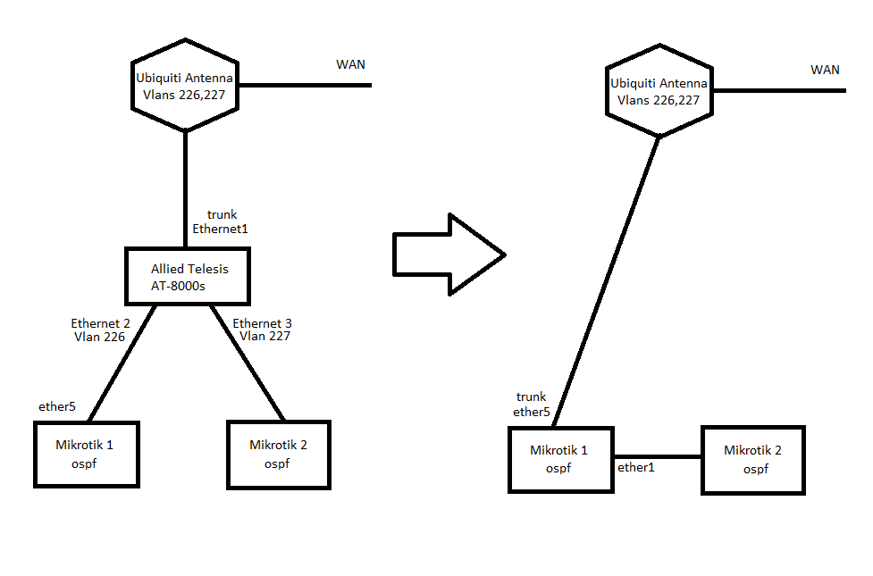

I have a WAN connection from a wireless antenna. The antenna is connected to a switch (AT-8000s, interface eth1 trunk vlans 226,227) and forwards traffic to 2 MikroTik routers that connect to ospf network.

The switch has broken, so if I connect the antenna to the first MikroTik how can I achieve the same setup, so that interface ether5 of MikroTik is trunk and ether1 forwards vlan 227 to other MikroTik (and which interface should then be the ospf interface)?
Here is a simple diagram of my topology (what I want to achieve is on the right side):
