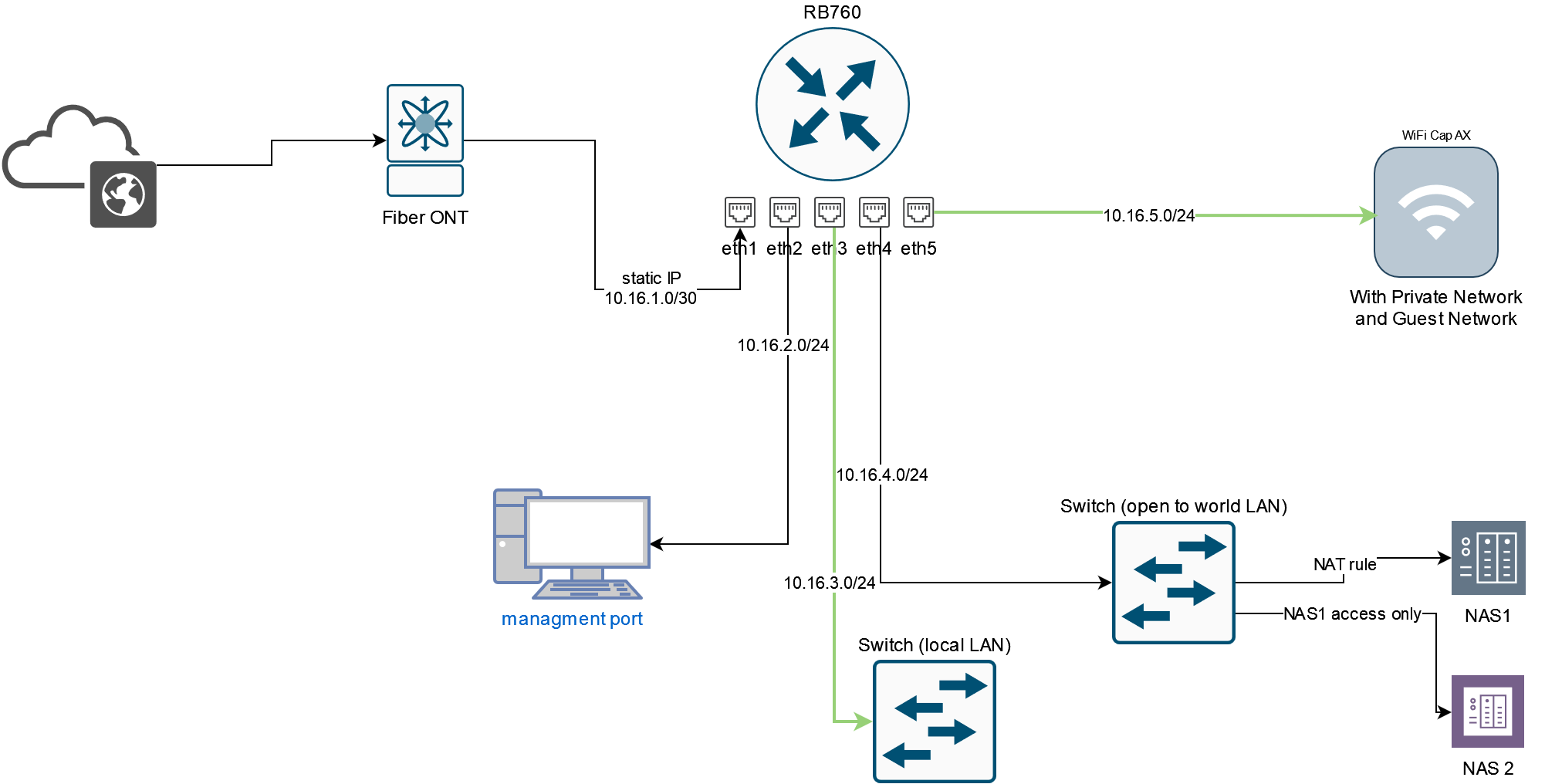

Configure mulitple DHCP Server on each ethernet port

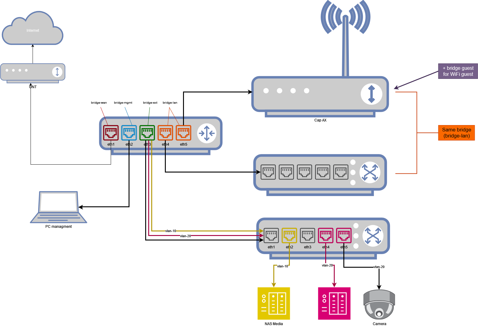

I plan to buy a Hex S (RB760iGS) wiht two switches (RB260GS) and one Cap AX (cAPGi-5HaxD2HaxD).
I would like to split network on each port to know who is connected on each port.
But I need all clients connected to the Cap can discuss with connected devices on one swtich.
The second switch, will be isolated of the local network. It’s destined to have some ports open on the web.
To identify easily who client is connected or who client discuss which eatch other, I need to assign subnet of each router ethernet port. Or, each switch have his own DHCP Server to identify the network where is the equipment
In my attachment, you see the network map I would like to implement.
I would is it possible or if is a good practice to do that ?

Here is my true network map. I have just two VLAN for the IoT and external access (opened to Internet).
Currently, I have two bridge for the WiFi, one dedicated for the LAN to work with the switch and another for the guest network. In the future, I make the guest network with a VLAN, I think.
All bridge have a DHCP Server and a IP range addresses dedicated.
It seems to work like this.
The question remains whether it is better for me to turn to VLANs to do all this or if I can stay with multiple bridges?
Likewise from a performance point of view, I am afraid that partitioning with VLANs will be more efficient and less resource-intensive for the router than doing that with bridges. Tell me what you think ?
Looking at the intricacy of the network diagram I still find it better and easier for management to use VLAN because if you use multiple bridges you’ll have to think of numerous scenarions and thus firewall rules. Looking at the true network diagram I’ll repost an edited for your needs config provided you want to use the same IP addresses for ether4 and ether5:

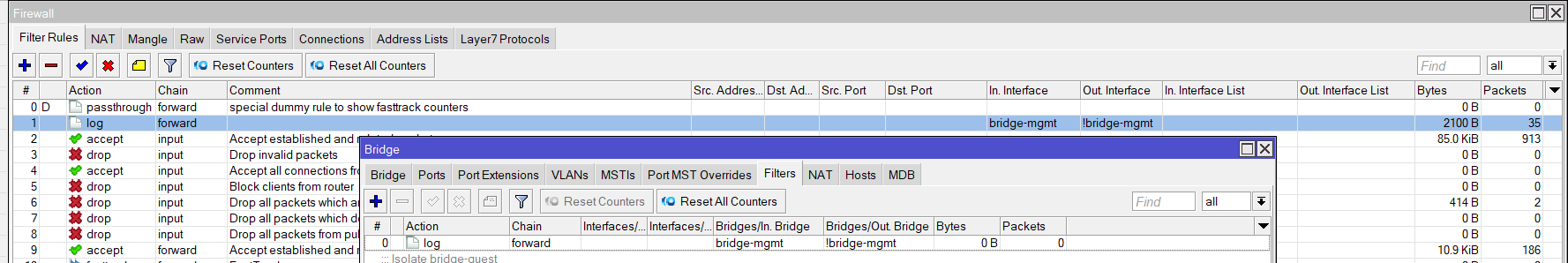

Above all I have the impression that there is a bug on the bridge filters which do not work.
The filter works on Firewall but on /bridge filter, only interface are filtered. I don’t know why.
But it doesn’t matter I’m going to change the entire configuration with vlans.
FYI, I’ve made some changes to the config (removed typos and misconfigurations) so please double-check before you apply the settings
Also, most probably the bridge filter rules weren’t working due to the setting “Use Firewall IP” being turned on
