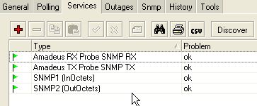

I have 4 probes configured in each monitored device (router). Blat is configured to send notifications by email in such a way that, for every monitored device I receive 4 notifications! Well, at the beginning it was ok, but now it’s a kind of complicated to read and distinguish the different probes configured.
Is there a way to configure Blat/Dude to send only one or two notification for each device, keeping the 4 original probes?

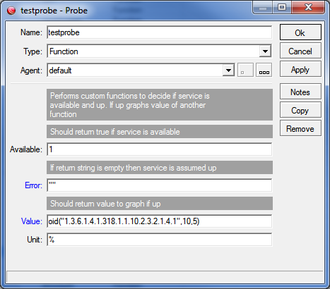

On the function you never want an email from probe put “” on the error line and the probe will never be in an error state so it will never send an email. You can still graph the value…

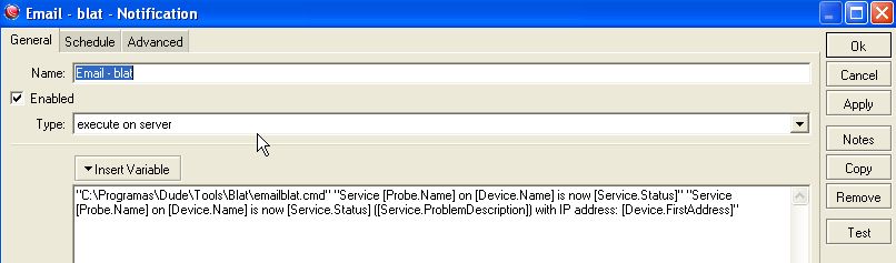

“C:\Programas\Dude\Tools\Blat\emailblat.cmd” “Service [Probe.Name] on [Device.Name] is now [Service.Status]” “Service [Probe.Name] on [Device.Name] is now [Service.Status] ([Service.ProblemDescription]) with IP address: [Device.FirstAddress]”

Open the probe SNMP1 in the error line put quotequote. The function will still graph the octets but you will never get a notification for that probe being down.
This probe will never generate an email but it will record the value of an APC temperature sensor if the device is up.
I am fairly certain I read your request incorrectly but maybe my suggestion will still help.

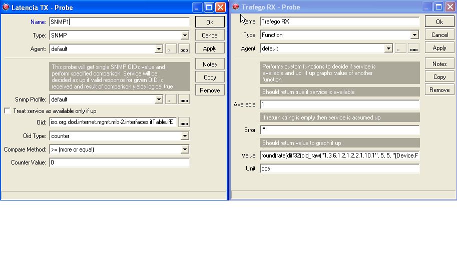

No sucess!
SNMP1 is not a function and doesn´t show that option. :C
The other probe is a function but that option “” was already configured and is sending emails notifications through Blat!
