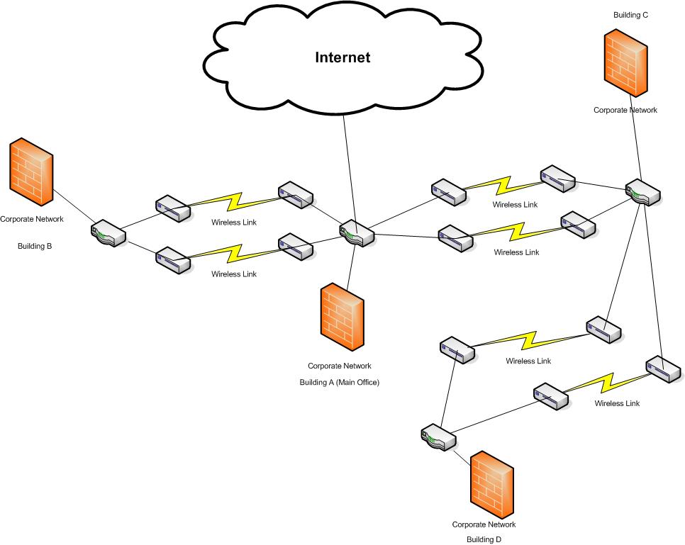

Building A will have an RB1100 that will act as my ISP router. I have an additional firewall connected to it with a public IP that my local lan is behind. It will use the RB1100 as it’s gateway. Connected to the RB1100 will be wireless bridge A and wireless bridge B that are connected via WDS to two more wireless bridges which are then connected to an RB493. To this RB493 is another firewall that my local lan is behind. My goal is to give this remote firewall a publically accessible IP from the range given to me by my ISP. This is so I can create a VPN between these two firewalls.
I still haven’t implemented this as other things have come up…but here is what I’m trying to configure…
Building A will have an RB1100. Building B, C and D will have an RB493. The wireless links are made with UBNT NanoBridges and configured to be transparent (assigned private IP for management only). This is all Layer 2 on the same subnet utilizing public IPs from my ISP for the corporate firewalls at each location, each routing to Building A to get internet access.
Does bonding still seem to make the most sense? Also, the RBs at each location will need IPs on the same subnet as the firewalls for them to all talk, right (public IP assigned by ISP)?
