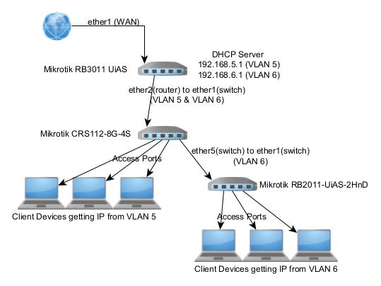

Hi, i’m struggling to configure the network like in the diagram below in attachment and had no success :frowning:.
Anyone can help me configuring and best practices that i should follow for that specific case?

Post what you have from all three devices.
each one gets a single bridge,
all smart devices get IP from trusted lan (or a separate managment lan).
All data flows on vlans, dont use bridge for dhcp.
