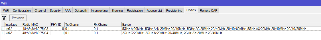

The strange thing is that the router believes that wifi1 is 5GHz radio capable (sorry, I tried twice to insert the link to image, it is attached)

hAP AX3 is a an AX device.
Starting from that AX line Mikrotik swapped the labels on devices having 2.4 and 5Ghz radio.
Wifi1 = 5GHz
wifi2 = 2.4Ghz.
So the router is actually correct. Wifi 1 IS your 5GHz radio.
You might be better of to start with default config and work from there to make your changes.
