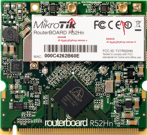

I have router board RB600A and mini PCI card R52Hn. I want configure antenna-mode and set it to ant-b value.
When I trying set antenna-mode=ant-b (telnet using) after giving command, RouterOS ask me a Numbers:.
What does mean Numbers parameter?
thank you!
on N use chains
see that pic.
He ask number over there device name. Antenna mode settings is not active for this wireless card. Each chain have only one antenna output. Use ht-rx/tx chain= to configure antenna-mode.
it not so simple. When we use V4.5 or V4.6 with 1 Antenne on J4 and setting HT-rx / HT-tx = 0 ist dosn’t work !!!
When we set HT-rx / HT-tx = 0 and 1 it works fine. Where is the Problem ???
dingsingo
What band settings you use? I just test it on 411 with 4.6 RouterOS in indoor setup each chain conform chain settings. When you set RX/TX =0 J4 working in both directions. When you set RX/TX = 1 both directions working over J5.
Set is only 802.11a with a vertical and a horizontal Antenna. Other Side ist was a R5H only vertikal Antenna.
set only 0 or 1 not work. RX 0 & 1 , TX 0 or 1 not work. Setting RX 0 & 1 - TX 0 & 1 works by signal 30 dB.
