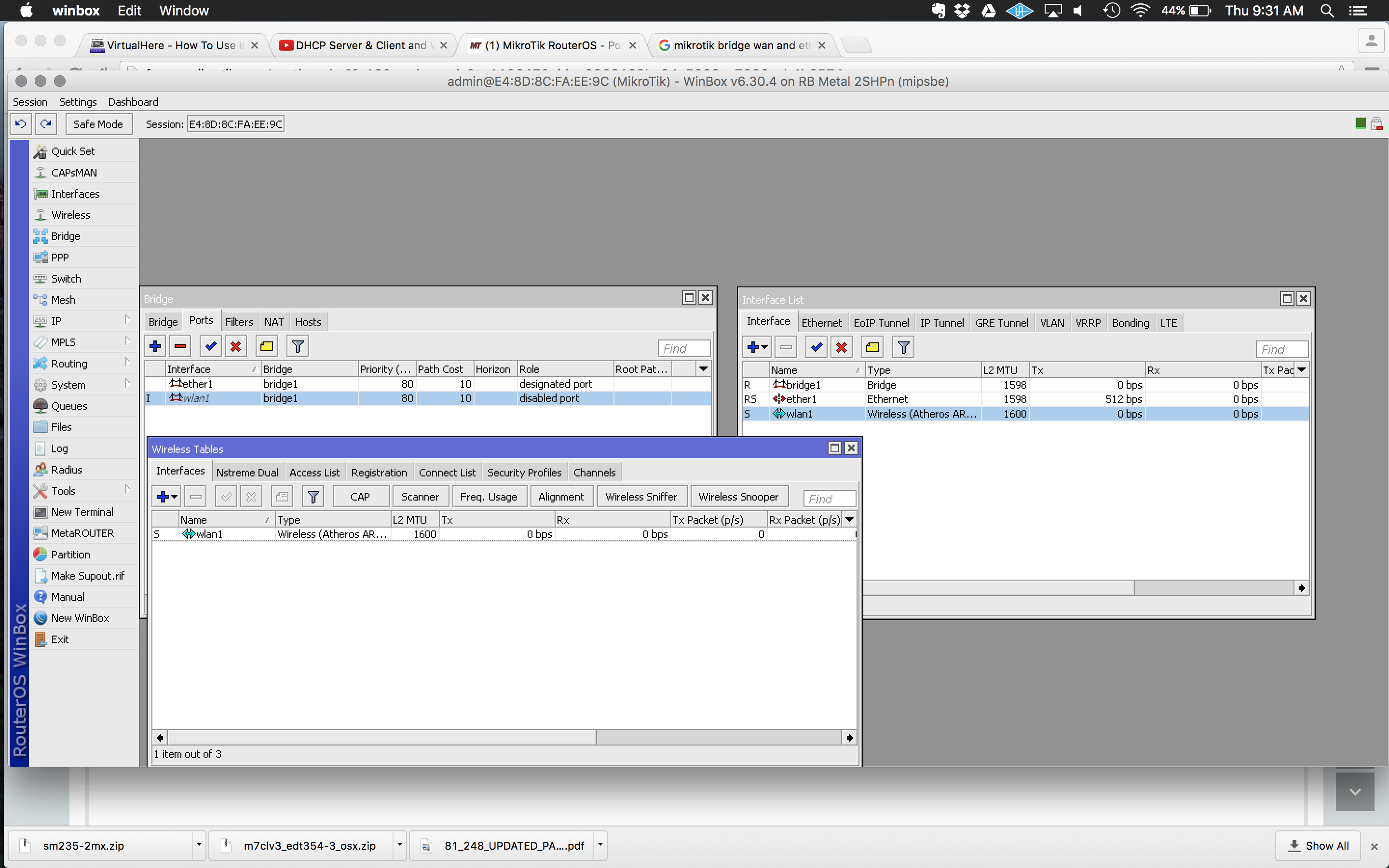

Alright, I removed the default config and reconfigured to AP Bridge in Wireless settings, then created a bridge, but when I add the wan port it says it’s disabled. I’m pretty confident I set the rest up correctly, and checked against other tutorials, what am I missing here?
So I don’t come across as lazy and trying to get the forum to do all the work, I’ve been reading and trying to figure this out all day, but no luck.
disabled port in bridge is not a problem. It will be enabled once goes up, and it will be once first client get connected to it.
Just make sure you are able to connect by client (security profile and other parameters correctly set at wlan interface).
