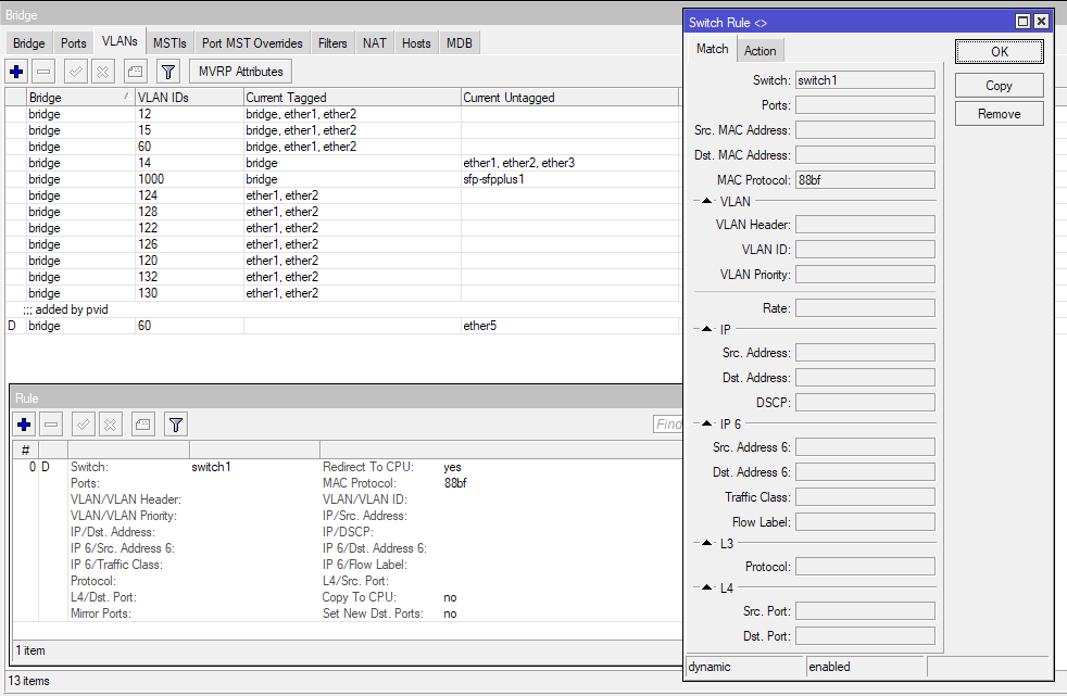

The RB5009 does have a dynamic "Redirect to CPU" switch rule automatically added for the 0x88bf EtherType, as the document says:
So, it probably affects admit-only-vlan-tagged only, OP might need to switch the frame types of the trunk port to admit-all if it doesn't work as expected.
EDIT:
After thinking more about this issue, I guess it only affects the situation where the CPU port is not part of the VLAN. In my screenshot above, it would be those VLAN 124-132 because for those the RB5009 only acts as a switch, with no bridge being tagged for those VLANs. If I had RouterOS devices connected to those VLANs and want to use the RB5009 as intermediary, the "Redirect to CPU" rule would be needed (because otherwise the CPU never sees any packets on those VLANs), and the restriction of that switch chip is that if we want to filter by EtherType 0x88bf, the packets cannot have VLAN headers.
But in case of the other VLANs, like 12, 14, 15, 60, 1000 in my screenshots, the CPU port bridge is a member of the VLAN already and can see the packets with EtherType 0x88bf without needing any switch rules. My tests (and OP's setup because the RB5009 CPU sees all VLANs) would probably still work even with frame-types=accept-only-vlan-tagged.
