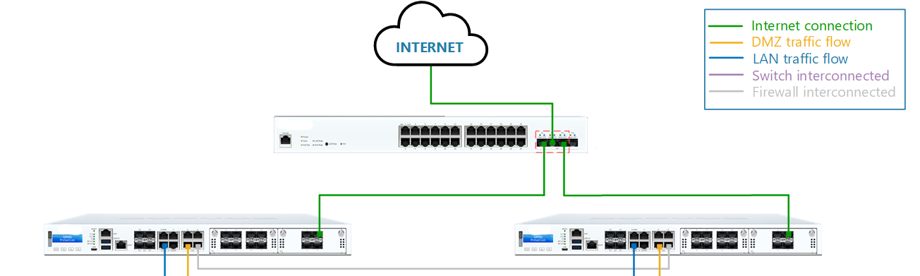

Hello, I am currently trying to use a CRS3xx device to act as a switch simply to allow 2 firewalls to resume it’s WAN connection should one fail. Basically 3 ports, 1 to the ISP, and the other 2 are used for each firewalls WAN port. I actually have a Juniper switch setup and it does work but we purchased this Mikrotik to take over the role but I am new to Mikrotik. This is what I would to have, first make sure the device has been secured out of the box and then as follows:
Ether8 - ISP Connection
Ether7 - Primary Firewall
Ether5 - Auxiliary Firewall
3 Ports on VLAN 300
In my case would you recommend creating a separate bridge just for the ports then assign the VLAN under the bridge? This device will not be used in other manner, it is simply allowing 2 firewalls to share a ISP connection. I don’t want to over complicate things but also want to make sure I’m not exposing anything or jeopardizing our incoming connection by a poorly configured device.
The attachment is basically what I am trying to achieve.
I think you have the gist of it.
Very basic bridge with three ports
One VLAN that is untagged on all three ports
Add fourth untagged port to the bridge so that you can access the ISP if necessary ( not sure of the ISP device setup but may not be required) on the same vlan.
Add a fifth port off the bridge to configure the switch and make changes…
Assuming there is physical security, its not like a switch in an open office area.
