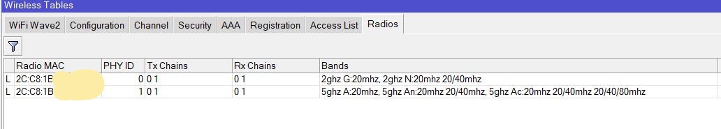

I have found a “radios” tab which has bands info. Radios there have corresponding MAC addresses to wifiwave2 interfaces. Why not add this info from “radios” tab to a separate tab inside wifiwave2 interface?
