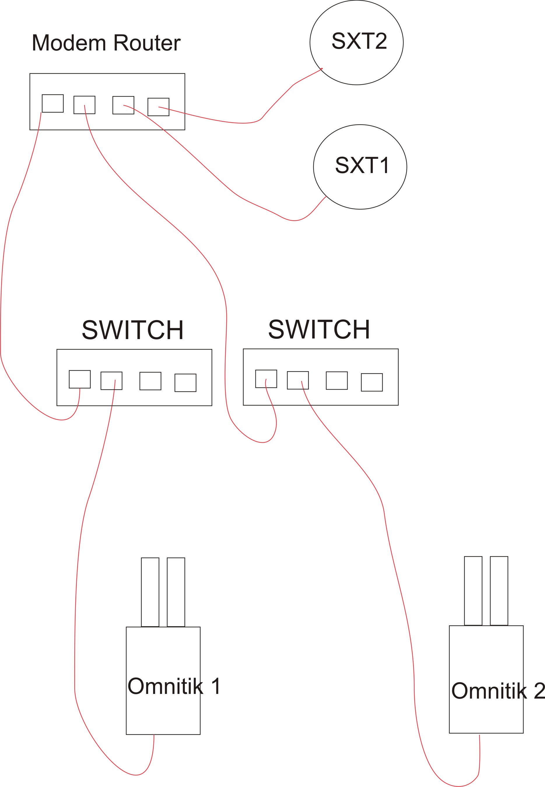

The only solution that I found is add another switch.

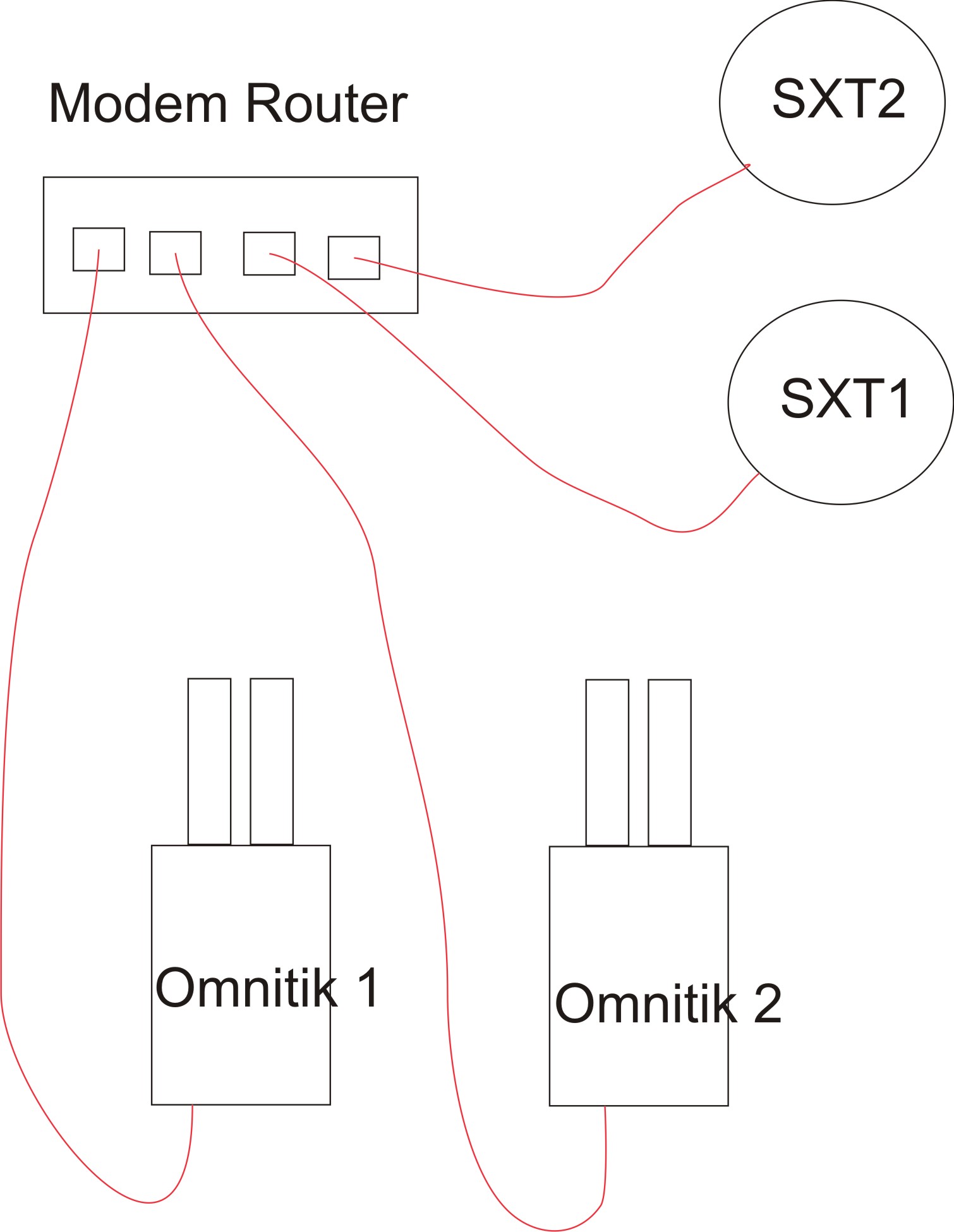

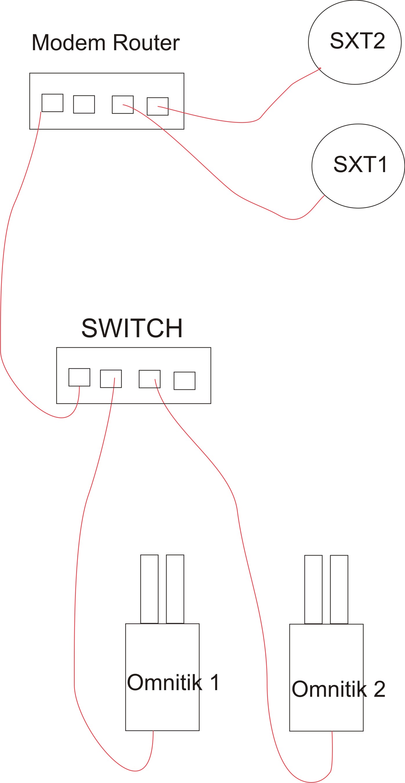

I attach 3 graphics to explain better. 1 and 2 don“t work. The only way that work is the 3.
The 2 CPE SXT never had problem. They work perfect. All equipment are in bridge mode

Can you show us screen captures of winbox trying to discover all of the devices in each of the three cases?
Did you originally setup one OmniTik; then back that configuration up and restore its configuration on the second OmniTik; then change the IP addresses on the second OmniTik to be unique?
If that happened, I wonder if the MAC addresses were cloned between the two of them and some form of STP is turning off the second switch port when the switch sees the same MAC address on two ports. Just a wild guess.
The winbox screen captures should show us the MAC addresses of all of the devices.
What model are the switches and modem/routers?
