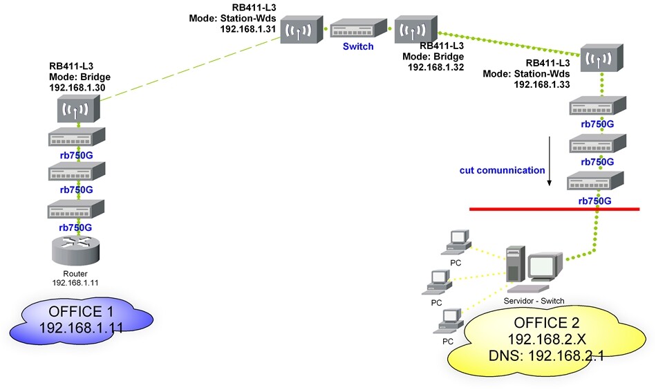

i am having problems to connect 2 offices by a bridge. i have not line of signal, and we have made a “repeater” betweens both offices, in a big build between them
I need to bring internet ptp to different Networks.
I create wds-bridge with rb411 L3
The problem is that we can connect to office with 192.168.3.x
Office 1 ( Bridge Mode) Rb411 L3
Lan - 192.168.1.X
GW - 192.168.1.11
DNS - 192.168.1.1
Office 2 ( station-wds mode) Rb411 L3
Lan 192.168.2.x
GW - 192.168.2.11 (this router will take off and take internet from Office 1) 192.168.1.11 with the actuall Dns over 192.168.3.X
DNS - 192.168.2.1 - keep this Server who gives dhcp, firewall, etc to pcs Lan 2.X
Now all bridges works fine, i can make ping to other lan from any cpe or rb750, but now i need to communicate to 192.168.2.X and give internet them.
which would be the best solution that you recommend me on some rb750G on office 2?thanks to all -
I tried routed wds-bridge unsuccessfully-
Thanks guys.—

I configure a rb750g
ether1 like Wan1 192.168.1.12
ether2 like wan2 192.168.2.12
ether3 dhcp wan2
at routes 0.0.0.0/0 => 192.168.1.11
but i can communicate with lan 2.X
at server , I need put route dst-address=192.168.2.0/24 gateway=192.168.1.12 at server 192.168.1.1.
but, Should I put in the servers 192.168.2.1 anymore?
