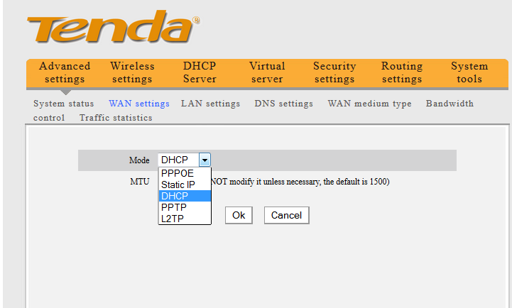

I have a wireless router from Tenda (W309R) that connects to a RB on ether3
I would like the RB to give the devices IP addresses instead of the Tenda itself.
I disabled DHCP on the Tenda.
On the WAN side for the Tenda has the option of DHCP ( which I selected) , static IP,PPTP and L2TP.
Please let me know if I will be able to do this.

Please explain how I would bridge the WAN ?
screen shot from my Tenda WAN options.

I think you need to disable DHCP-server on the Tenda LAN-setup. Then setup Tenda LAN ip-address as dhcp-client. Next step - connect Mikrotik-ether3 to LAN-port of Tenda.
I’ll repeat again, don’t use the WAN port of Tenda. Use LAN-port.
Thank you guys
Turning off dhcp and connecting to Lan port sorted out the issue.
