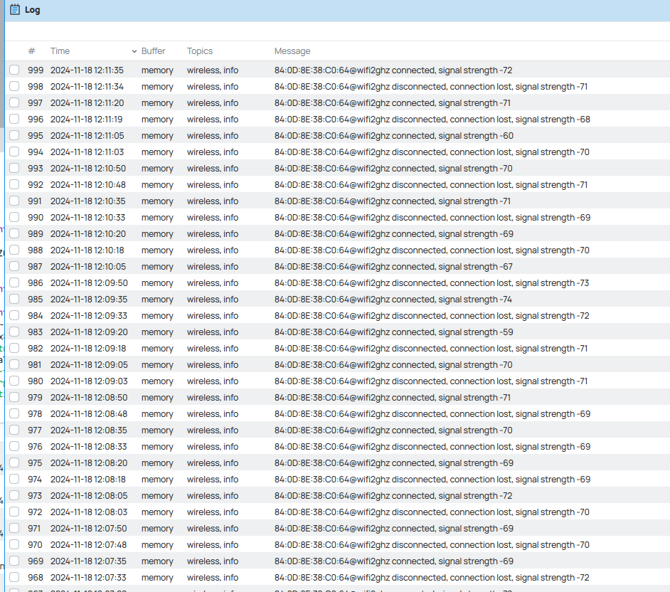

Another device (Emporia Vue) at about 100 meters (but behind the wAP) tries to connect to wifi2ghz and continuously gets “connected” then “disconnected”, even with signal strength around -70.
 16:21:16 wireless,info 84:0D:8E:38:C0:64@wifi2ghz disconnected, connection lost, signal strength -70
 16:21:17 wireless,info 84:0D:8E:38:C0:64@wifi2ghz connected, signal strength -60
Nothing else in the logs, even with topics wireless and debug enabled.

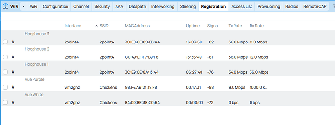

Here is the registration table for the 3 rock-solid connected devices:
[admin@355wap-carport] /interface/wifi/registration-table> print brief
Flags: A - AUTHORIZED
Columns: INTERFACE, SSID, MAC-ADDRESS, UPTIME, SIGNAL
#   INTERFACE  SSID     MAC-ADDRESS        UPTIME     SIGNAL
;;; Hoophouse 3
0 A 2point4    2point4  3C:E9:0E:89:EB:A4  11h1m54s   -83
;;; Hoophouse 1
1 A 2point4    2point4  3C:E9:0E:8A:13:44  10h31m12s  -76
;;; Hoophouse 2
2 A 2point4    2point4  C0:49:EF:F7:B9:F8  10h17m38s  -81

According to your posted and commented config “84:0D:8E:38:C0:64” is “Vue White” and not “Emporia Vue”.
Only in case that the Emporia Vue is the only device to connect to the wifi2ghz interface, the following command might help:
/interface bridge port set [find where bridge=bridge interface=wifi2ghz] edge=yes
The background is the following: if no station (client) is associated to an AP, the “ethernet side” of the AP goes down, so if it is configured as a port of a bridge, the bridge behaves as if you disconnected a cable from the port. Since by default, RSTP is allowed on bridges to prevent L2 loops from forming up in case of cabling mistakes, the port does not forward traffic for some seconds after you “connect the cable”, waiting for eventual RSTP BPDUs to arrive. During that time, the associated wireless station cannot obtain a DHCP lease as its DHCPDISCOVER packets get nowhere. If the Emporia Vue implementation is “impatient”, it may give up and start from scratch before the RSTP switches the bridge port to “forwarding” state, so the cycle keeps going on like this.
Sorry for the confusion:
“Emporia Vue” is the name of the company (Emporia) and product (Vue). I stated it this way so the reader would know what the device/client is.
“Vue White” is my internal name so I can identify which Emporia Vue this is (I have many).

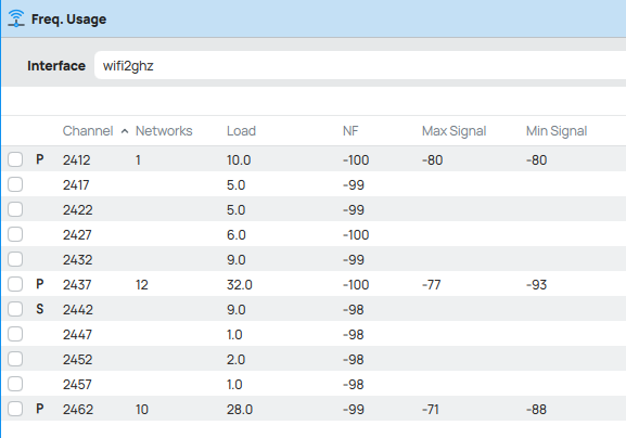

Crowded, well yes, the MT scan shows 30 AP/SSID in 2.4GHz and the same number in 5 GHz band.

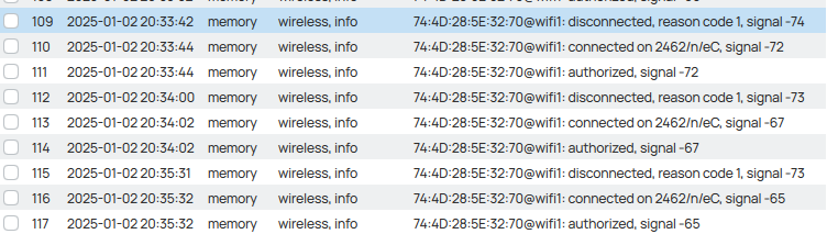

I have a hap ac2(AP mode) with wifi-qcom-ac connected wirelessly(2.4gHz) to another hap ac2(station bridge mode) every several days it goes through a period of connection disconnection cycle (up to 15 minutes) for no apparent reason signal is between -70 and -74, reason code 1 is given on station bridge side. STP set to None all the way thorough nothing in between.
Topology as following
RB5009 (NAT Router) Ethernet -----> hap ac2(AP Mode 2.4gHz) ------->hap ac2(Station Bridge Mode)
You could start a new topic, as your problem is probably not related. Interference might be your problem, especially because you use the complete bandwidth of wifi at 2.4GHz.
Half (give or take) actually. 2.4GHz band (for anything newer than 802.11B) is 70MHz wide (in NA and related parts of universe) or 80MHz wide (elsewhere) ... and 2462/n/eC channel is 40MHz wide.
I think this is very similar to original posters issue, even reason code is 1, Only difference I can see is my network stack is entirely mikrotik, I don't think the issue is interference, also tried 20mHz same issue happens...
Yeah yeah, I know. There is more bandwidth. Let me try it in a different way:
Frequency 2462, Control channel eC and channelwidth 40MHz makes use of frequencies from (roughly) 2432 to 2482 which doesn’t overlap with channels 1/2/3/4/5 (2402 to 2447). The chance you run into interference is high.
AFAIK reason code 1 is undefined. Could be anything. Are you using auto channels? Did you have the exact same issues while using 20MHz?
Can you share the config of bot hAP’s?
Yes auto channels, exact same issues while using 20MHz...
here is the WiFi config:
