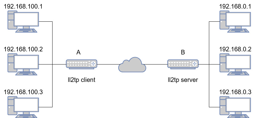

Hi i have a simple network connected by VPN l2tp describe in attachment.
in my scenario i can connect from 192.168.100.3 to 192.168.0.1, but i need to connect from 192.168.0.3 to 192.168.100.1
what is the best way to make it possible?
my best guess is, i have to create Mikrotik A as l2tp server. i have to use 2 l2tp connection. i try to figure out is there any other solution here using 1 VPN connection?

because it at 2 different location, Mikrotik A using ISP a and Mikrotik B using ISP b.
am i in a right direction? or maybe there is another way to do it?
i just want to make A and B can connected each other as if local LAN using secure connection

  • I need to have the remote users in B. access subnets on either router
  • each Mikrotik have IP Public, i already test to make mikrotik A as server and mikrotik B as client and vice versa with no problem
Read this then, wireguard is much easier.
Its simply a matter of ensuring allowed IPs and IP routes match up and firewall rules allow the traffic.
