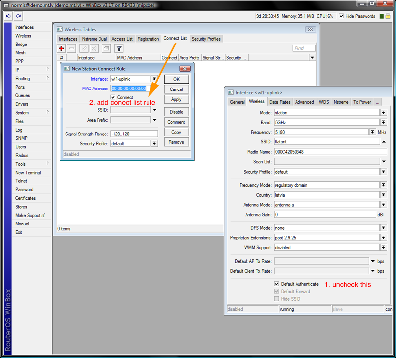

I would like to get a station WLan connect only to the AP in the connect list even if the AP is down.
I read in the OS manual that this can be done in a terminal but would like to do this in WINBOX please.
As I understand one should get the default connect to be = no and then the WLan should only get connected to the connect list rule?
I cannot however get this setting in WINBOX.
Appreciated.
Tom
Something like this:
  1. Unckeck “default authenticate”
  2. add rule with “connect” for your AP’s MAC
