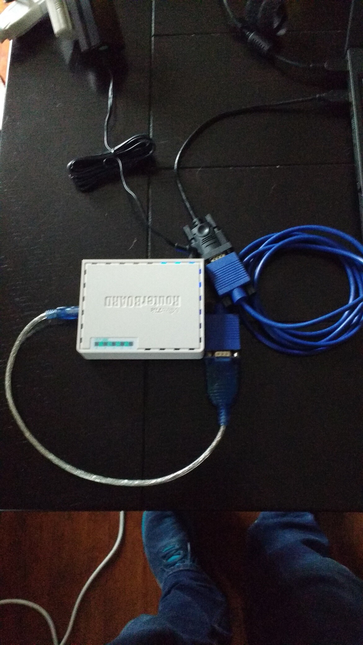

I’ve attached an image showing me serial consoling into my new hEX.
You may have to add a console on your MikroTik w/the /system console add port=<usb#> term= command.

If it’s not that then look at my previous post about configuring the MikroTik to use the /system console correctly. Does your model have a bit in serial port or are you doing a USB to Serial on the MikroTik as well as the computer like my picture?
