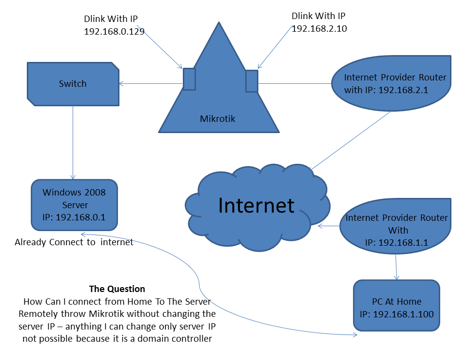

Hello i add a picture how we are connected to internet and how the server is connected Kindly for help.

Set up pptp or other vpn access to mikrotik and use that. Or set up port forwarding.
Both are covered in the wiki,
I’m sorry I don’t think I ever got an email about a reply on this thread. But yes you will need to setup dynamic dns and then setup PPTP.
http://wiki.mikrotik.com/wiki/Dynamic_DNS_Update_Script_for_DNSoMatic.com_behind_NAT
http://wiki.mikrotik.com/wiki/Manual:Interface/PPTP#Connecting_Remote_Client
