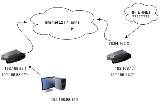

I have Site-to-Site L2TP connection.
All works excellent, but how to connect from Internet to address192.168.88.150:8181 ?
Option
add action=dst-nat chain=dstnat dst-port=8181 protocol=tcp to-addresses=192.168.88.150 to-ports=8181 on router with 192.168.1.0/24 don’t work.
Any solutions?

can 192.116.1.0/24 communicate with 192.168.88.150?
As I write - All works excellent, that mean in local network 192.168.X.X no problems.

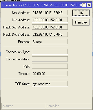

Of course I test this rule from internet and counters count incoming packets, but there are no connection with host 192.168.88.150 and internet host.
Add a rule to the mikrotik at 88.1 to passthrough any traffic that matches any such connection coming in and also watch its counters. Also add the two reply columns in winbox so you can see how it’s natting the connection.

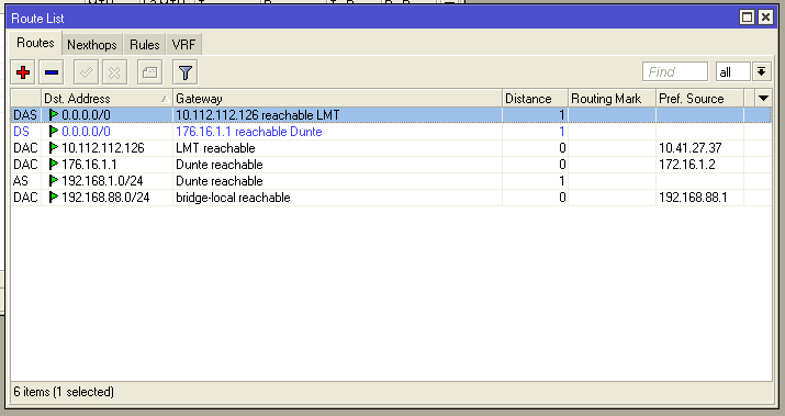

you need to test that the device or interface that receives the request from the world can route back to the intended server (and that replies go back as expected)
It is possible that 192.168.88.1 unable route packet to 192.168.1.1, but route all packet through LMT (3G modem) interface to internet. Because sync request from 192.168.1.1works Ok.
Any ideas?
