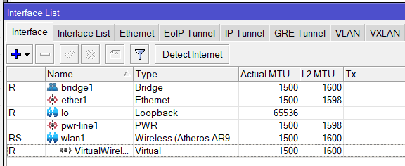

@bpwl Thank you for taking the time to reply to my post.
Iam still a bit lost in my Map Lite configuration to be honest.

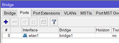

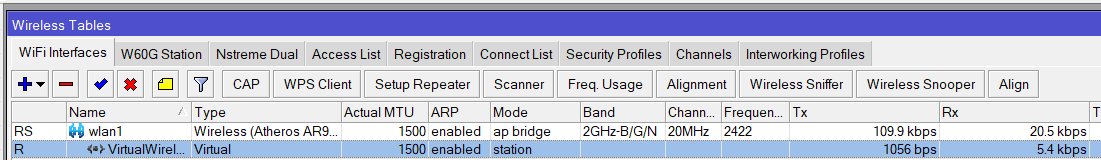

  • My WLAN1 is in AP bridge mode
  • My VIRTUAL WLAN is in station mode

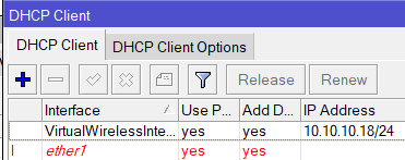

  • Virtual WLAN interface has DHCP client set and able to connect to “guest network” and received an IP address

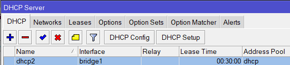

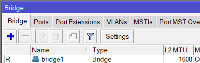

  • DHCP server is running on BRIDGE1 interface
  • the only port on BRIDGE1 is WLAN1 interface
  • my interface is setup as follow: LAN == BRIDGE1 ; WLAN == VIRTUAL WLAN

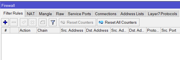

  • my firewall rules is empty
My VIRTUAL WLAN in connected to the “guest network” and able to connect to the internet, however the internet connection is not available on WLAN1.
Perhaps I misunderstood how to configure the bridge. Addition to this I need some help with firewall rules, since nothing is there Iam not sure how to configure this.
It was all correctly set in the default firewall rules.
The DHCP client should, besides the IP address and netmask, also correctly add the needed IP route, and set the IP address of the DNS server to use.
The default firewall rules work with 2 predefined "interface list"s , named “LAN” and “WAN”
Then the default rules will:
-allow acces from the “LAN” interfaces to the “WAN” interfaces
-protect the “LAN” from attempts “not coming from LAN” interfaces
-do the needed NAT address translation for the outgoing connections, with the firewall “NAT” rule for the “WAN”-member interaces
I do not have any firewall rules in place and have not delete them, so how do I get the default rules set?
And also is my understanding correct that - the only port on BRIDGE1 should be the WLAN1 interface?
Thank you
