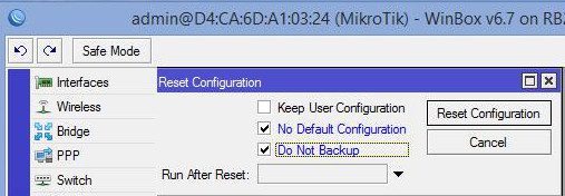

First, remove the default settings.
Try this
