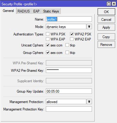

Ok, but I think the problem is when you disconnect, the following message appears in the log “Disconnected, management-protection failure”. Now, for example, all customers disconnected and log “Disconnected, request to disconnected from registration table”.
turn off Management Protection, unless you are using it - in which case, set a password.
